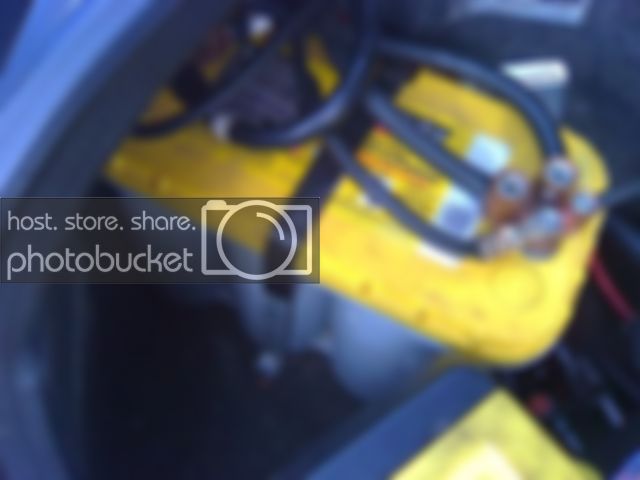

This is one reason why people use buss bars instead of an ugly mess of 6inch jumpers when doing multi-batt setups. A standard 2 x 1/2 copper buss bar will flow close to the same as 4 runs of 4/0 //content.invisioncic.com/y282845/emoticons/fyi.gif.9f1f679348da7204ce960cfc74bca8e0.gif
