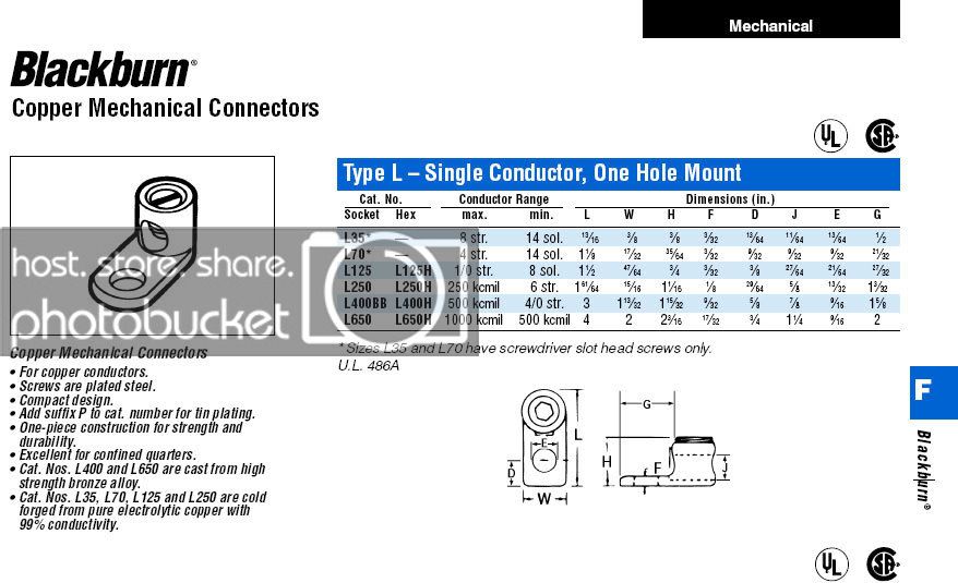

i just found this:
http://www.usahardware.com/inet/shop/item/30220/icn/20-067553/thomas_betts/l70.htm
still looking.....
