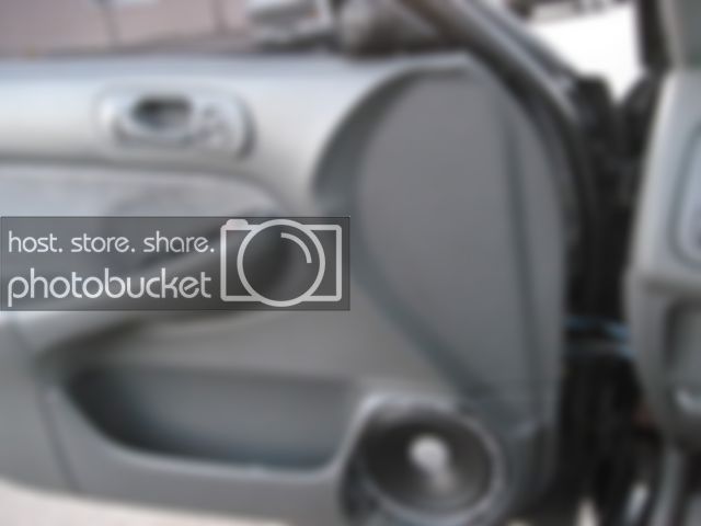

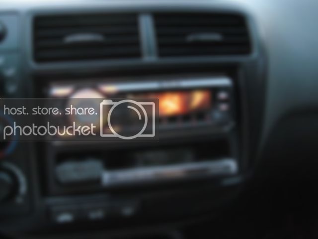

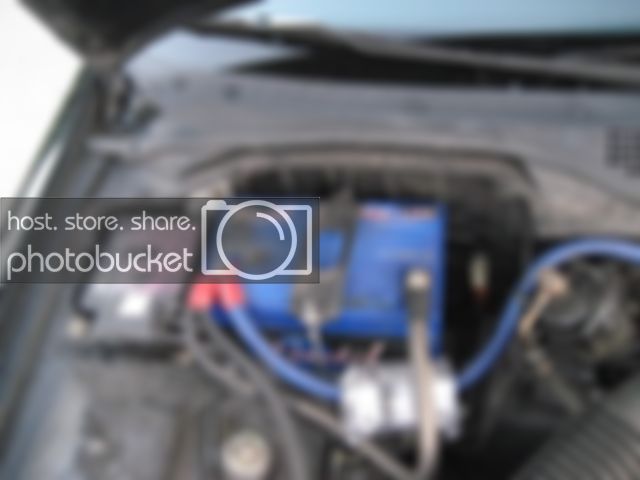

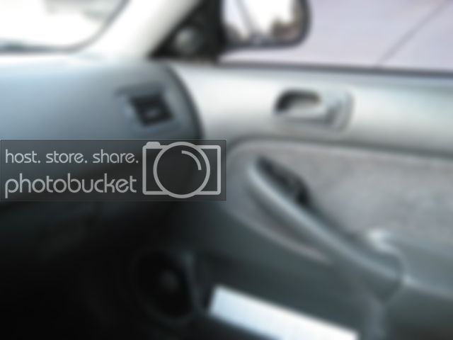

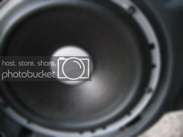

heres the rest of my set up if anyone cares:
i took the grills of for the pics so dont think anything funny. I just need to get the MDF rings that james made for me in and do the big 3. and I think i'll be set for a while.
Nice gear. Pretty close to my setup. I almost went with the US Amps Merlin series too but I forgot how broke I was, so old school MTX Thunder series is what I went with.
