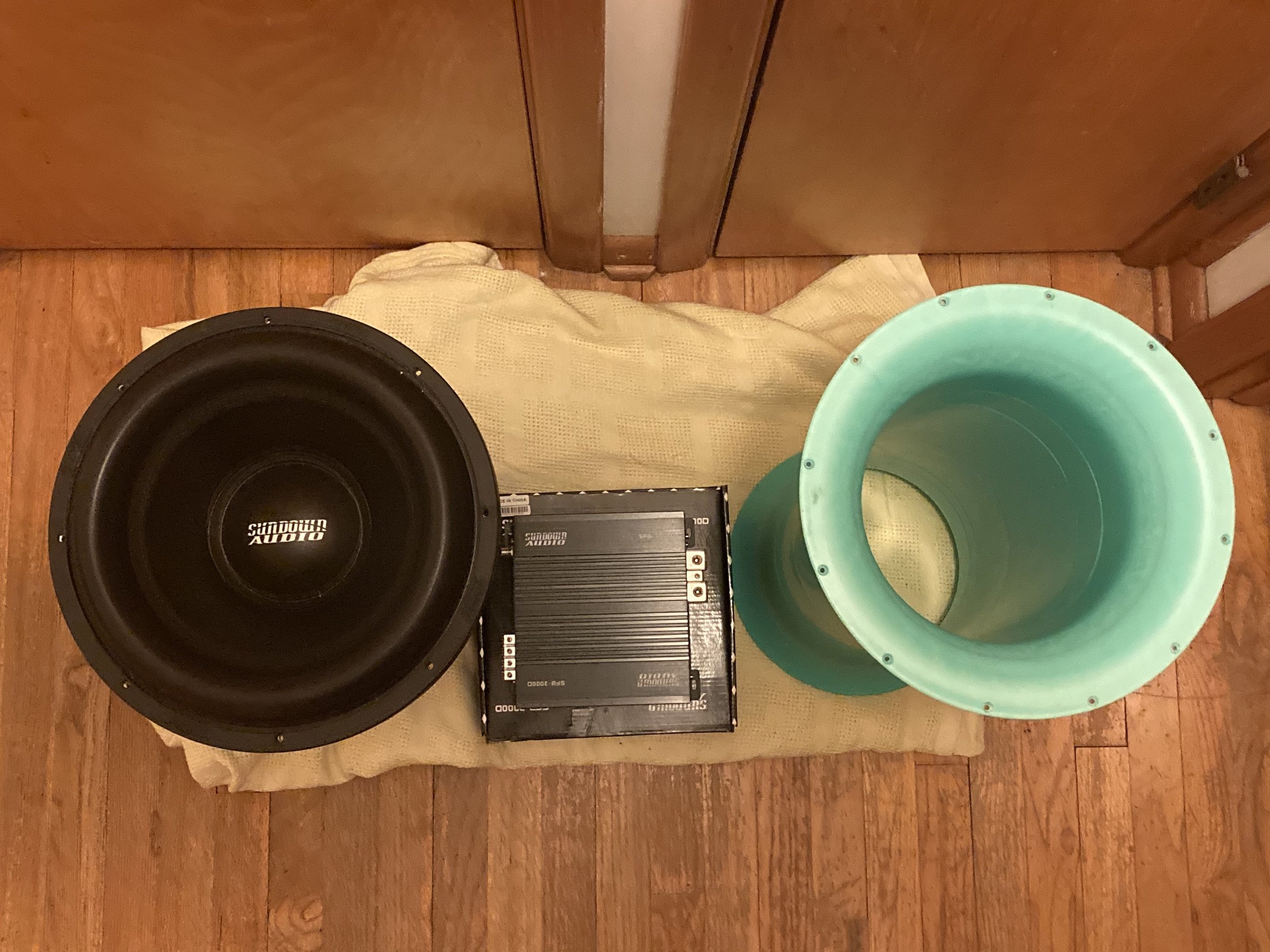

My 8” from Big *** Ports arrived today so I can finally move forward with my build and stop just staring at the stuff sitting in my house.
The vehicle is a 2006 Acura RSX Base model and a Sundown Audio SFB 2K will be powering the sub. I want it to be as musical as possible with quaking lows. My original plan was to compete in IASCA or MECA music classes...
