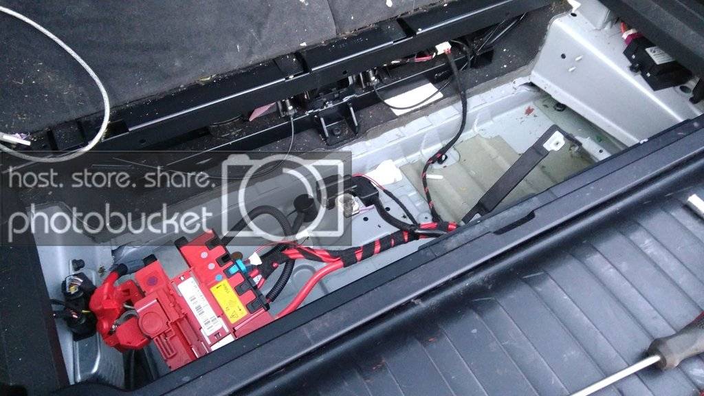

I am trying to build the box to fit in here under the floor away from the wife and kids and not taking up to much boot space car is BMW X5 2011.

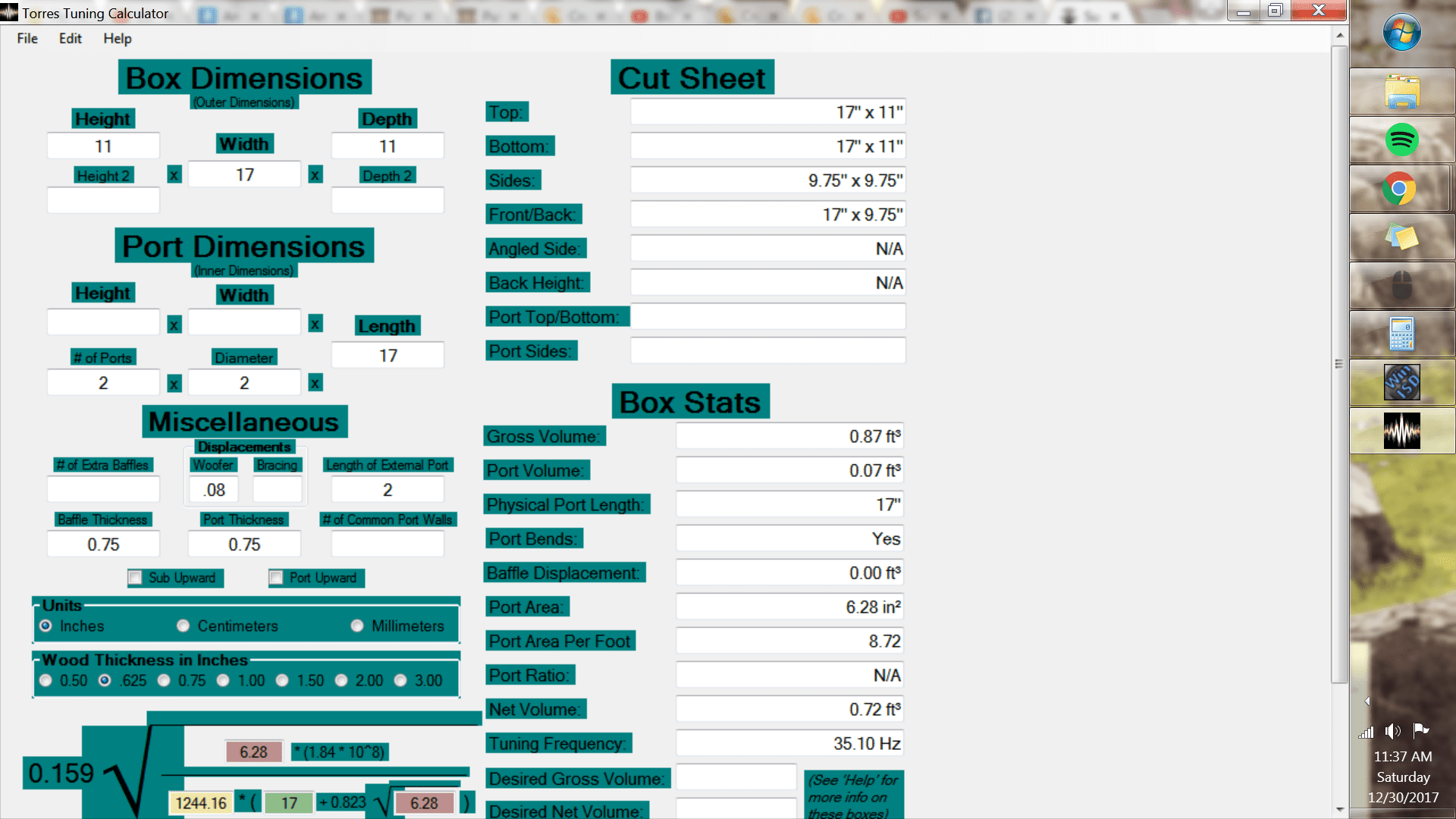

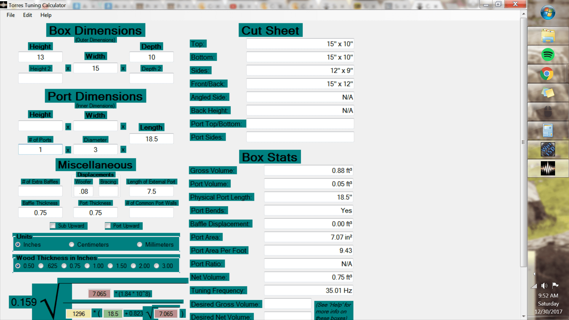

Any ideas with my max dimensions and port size? aero or l shape port?

yes an 8 would work a lot better. Has to be aero. Slot will not be anywhere near enough port area.
Do you have room for a pair of 2 inch round ports or one 3 inch port to portrude out of the box? You have the airspace but you dont have the length of the box to get a proper box tuning.
this is with .5 inch thickness wood, use plywood or baltic birch, its stronger than mdf.

yeah 1.25 cubic feet NET meaning after subtracting the space the sub and port takes up along with the wood thickness. Which literally would require 1.5-1.75 Gross cubic feet starting. I'd just suck it up and lose some cabin space in all honesty. Make it so its easy to disconnect safely if you ever need to use the cargo area, it's simple to do.
