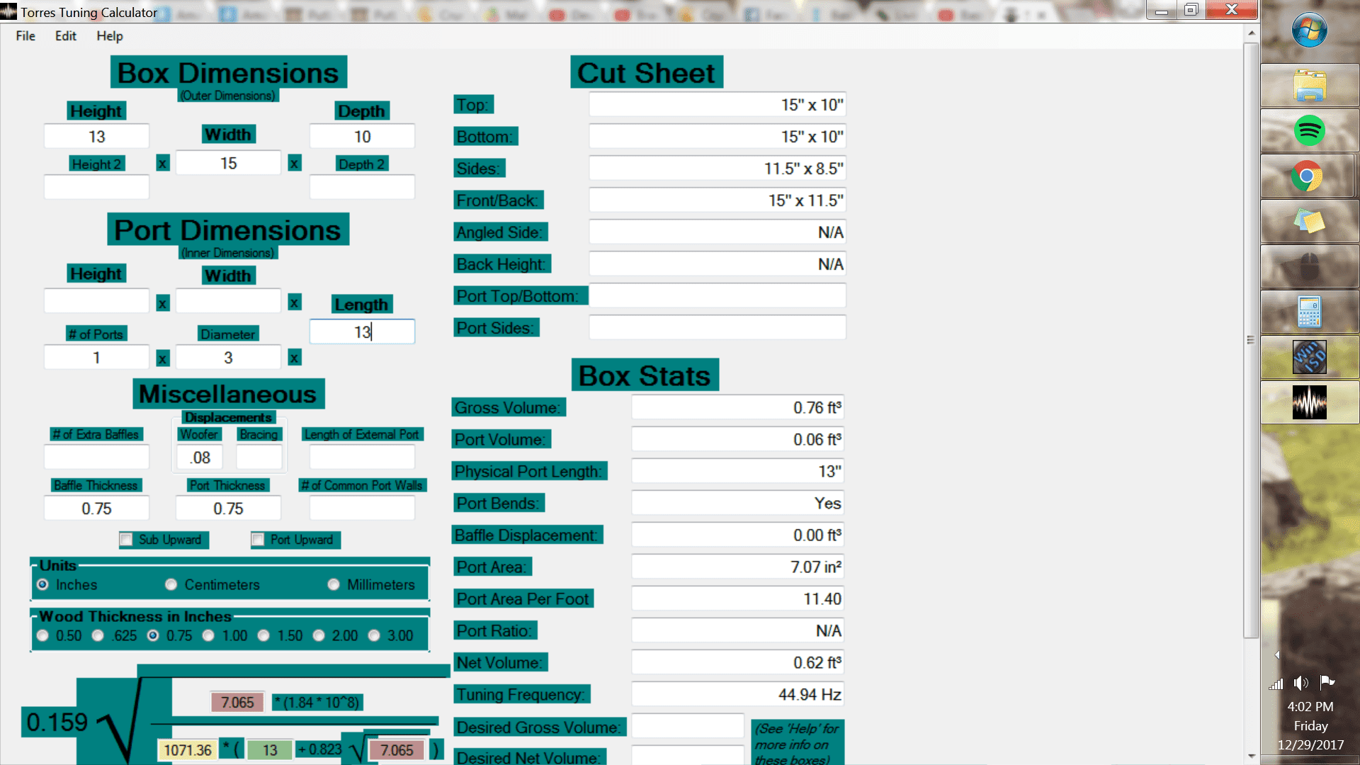

My max dimensions I can work with are 15" x 10" x 13"
would sealed box work better with these dimensions or ported?
Thanks in advance for any advice

1.15 ft3 net and above IMO... that's a.d. of course... 1.3-1.5 net looks to be great... that .93ft3... wow... maybe with a slightly higher tune (35-38hz) and an external 4" port... but it will be long... lol... over 20" easily... and wouldn't go low too well (30hz?)... IDK... I can play with it and see if you want... no predictions tho...
and yes... ported is the way to go
IDK where you and poolman got .93 Its .76 before sub and port displacements and considering how short the port length has to be with how little airspace, you will get nothing else but a burp box. Its not even enough for a sundown SA 8. He's already going to be struggling with a sealed box that might need polyfill already.
I just read .93... I never checked... never entered the measurements into Torres... duh!
When you quote a comment, try to delete the website link of the picture from my comment, it makes the thread A LOT less cluttery with repeat pictures. Excess pictures can actually derail a whole thread.
But yeah nonetheless waaay too little airspace to do jack sh*t.
I agree... bad day here... I'm out
Ok what would be optimum box size for this sub ported and I will mess around with space and measurements? I want to get the best out of this sub as it is only 10"

IDK where you and poolman got .93 Its .76 before sub and port displacements and....
Right on Jeff, thanks for catching that! its been a while since ive been on the site and interested again. i subtracted wall thickness, forgot box have walls on both sides //content.invisioncic.com/y282845/emoticons/smile.gif.1ebc41e1811405b213edfc4622c41e27.gif
