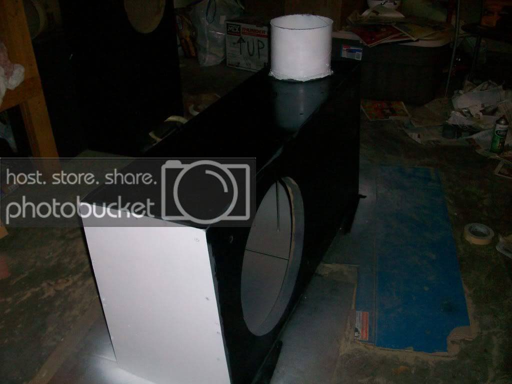

Sanded off the old glue best I could but it still sucked painting over it. You can see the mis-colored looking spots are from glue.
Going to pick up some more 1/0 and speaker wire
if you have some one with a meter cut off and inch at a time to it stops getting louder first find your loudest freq on a tone then test 2 to 3 hrz below and above that after each inch to see if your peek freq changes with the box tuning
