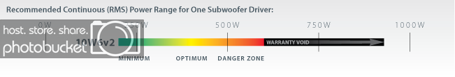

Also, if I were to go down to a 10w6v2(as opposed to a 12) I 'MIGHT' be able to get away with the 300w...Here's the specs for it from the JL site.
Continuous Power Handling (RMS) 600 W
Recommended RMS Amplifier Power 200 - 600 W
Nominal Impedance (Znom) Dual 4 Ω
As you can see, the "optimum" area looks to be at around 350w.
