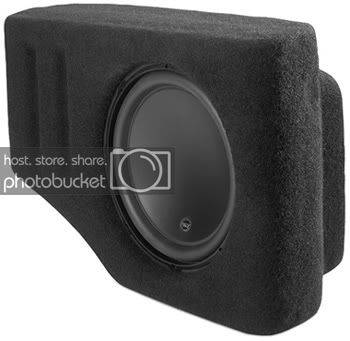

Edit: I plan on upgrading my sub eventually, the dealer suggested the JL Audio "Stealth Box" SB-N-XTERR2/12W3v3/2
but, I've read that subs 'aimed' from the side do not sound as good as subs aimed toward the back...I do want to keep the vehicle as close to "stock" as possible.
(don't want to have to move or RE-move the box every time I need to haul something) Thoughts?
(don't want to have to move or RE-move the box every time I need to haul something) Thoughts? no experience with the JL stealthboxes but you could always just run a sub that likes small boxes like the Dayton Reference HO. I'm sure that wont take up enough space to be a bother but thats up to you.

Here is the stealth box I've been looking at...He said the XD600/1 would be perfect for it...It rms's @ 500w (with a peak of 1000w)
