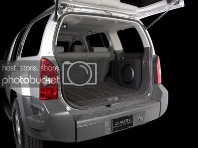

Here is the info on the sub/stealth box...anything stick out to you guys that I should be worried about?
SB-N-XTERR2/12W3v3
The Xterra has been a solid success for Nissan thanks to its utility, ruggedness and versatility. When considering a subwoofer upgrade, you don't want to give any of that up... you just want great bass added to the Xterra's long list of bonuses.
To accomplish this, the Stealthbox® tucks neatly into the side panel of the cargo area and sacrifices very little cargo space while also staying out of the way of the rear speaker locations and cargo cover.
Lurking inside is a single 12-inch subwoofer that packs a wallop and delivers outstanding fidelity. The subwoofer driver is protected from loose cargo by the included steel mesh grille, so you can load up your hatch without worries.
The Hard Data: Contains one 12W3v3-2 in a sealed enclosure. 500 watt power handling. Wired for 2 ohm mono. Stealthbox® installs in passenger side rear cargo area. A steel mesh grille is included to protect the subwoofer driver.

It seems to me that you really like the look of the Stealthbox over anything. Oh BTW, when the dealer says it designed for your vehicle, all that means is that it fits. I doubt it'll sound bad, but I'd be hard pressed to say youre getting the best out of the woofer, but in the end, its your money and you have to like the way it sounds. If it were me in the situation, though, I would buy a JL 12w6v2 or Dayton Reference HO online and take it to the dealer and have him build you a nice looking box for it that will get the best results from the woofer without sacrificing a nice clean look in the back of your vehicle. I can personally tell you that if youre really after SQ, that w3 is OK at best, but the w6 and Dayton are miles ahead for SQ. Boston Acoustics also makes nice subs as well. TC sounds is supposedly good for SQ too. The Dayton really gets my vote here, but go with the w6 if you feel more comfortable with JL Audio, have the money, and want it a little louder. My car is setup for SQ as well and I run the Daytons and love em to death. Also have had the w6, and I say both will be miles ahead of the w3 youre looking at getting.
