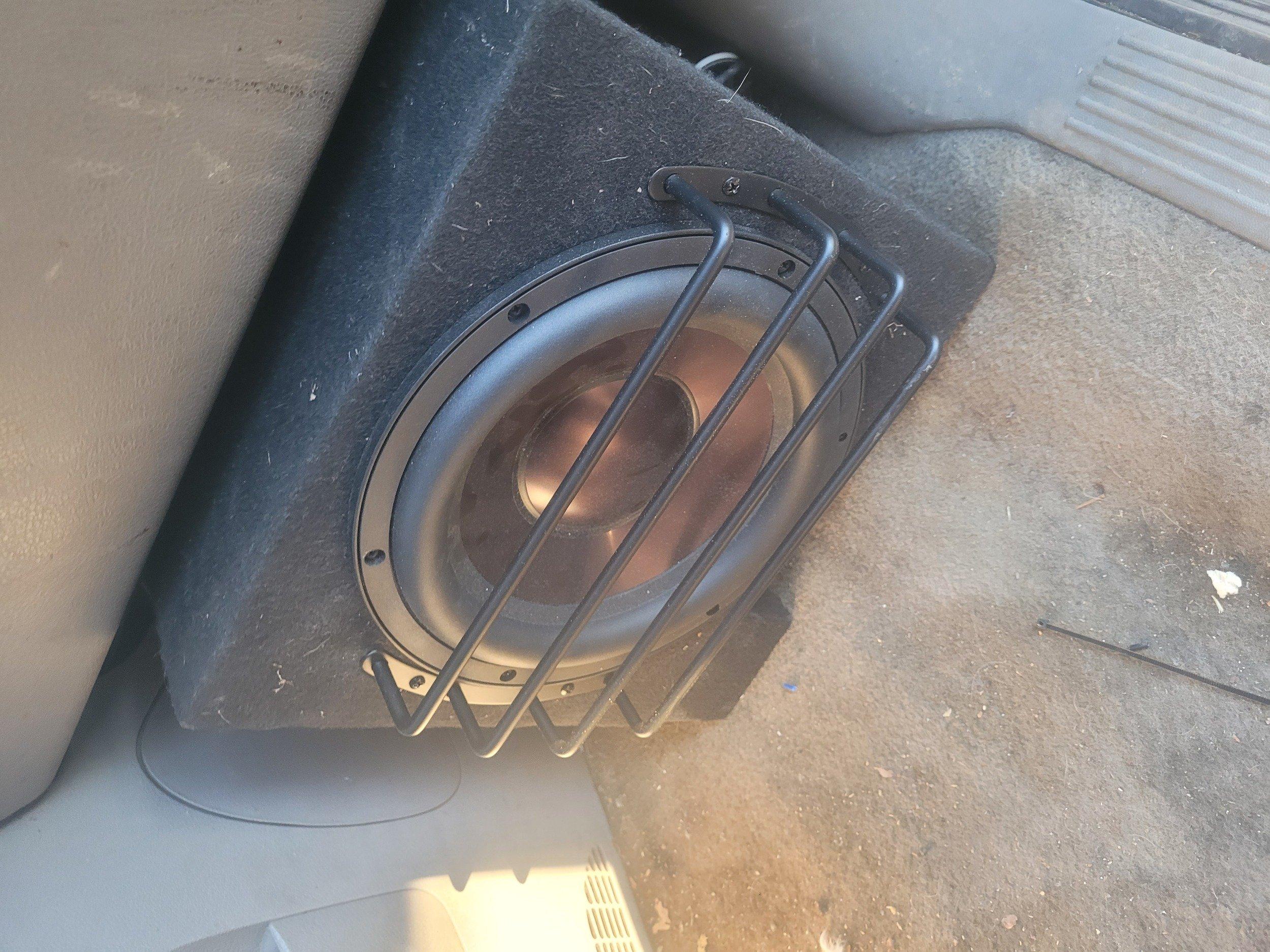

The svc ho subs do really well in a small box. I had the 10" in a box barely big enough for it to fit and it still played lower than I wanted it to 😂
Guess I have a lot to learn bro cause that doesn't make sense to me at all :)
I was using it as a front sub in Saturn. Ideally I wanted to choke it out with too small of a box since I only wanted to play in the 45-150hz ballpark. To cover the gap between my 15's and mids (like a beefy midbass). Even after putting blocks in the corners it'd still play into the 30's with gusto.
That is ridiculous, I love it.
So far the SVC seems to be a great fit..... but people keep interrupting me at work so the research will have to wait.
