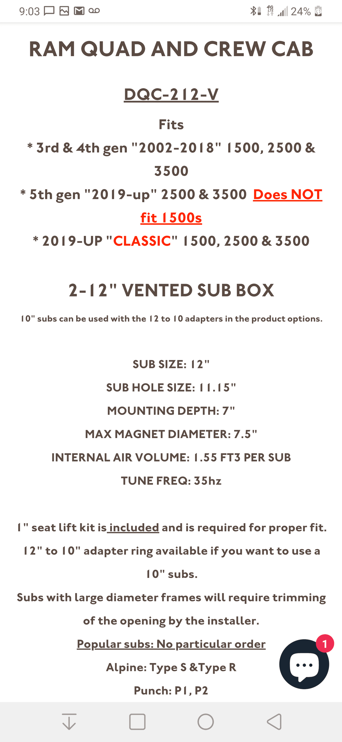

the Ram crewcab enclosures I looked up are ~.5 cuft per side. Looks to me like there is barely enough room for the basket and motor. That enclosure just screams 10" subs to me.

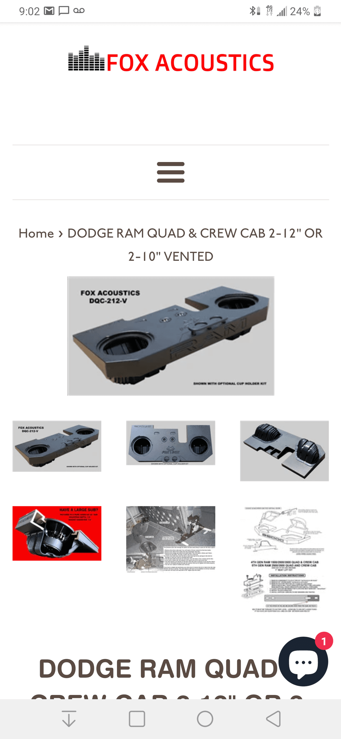

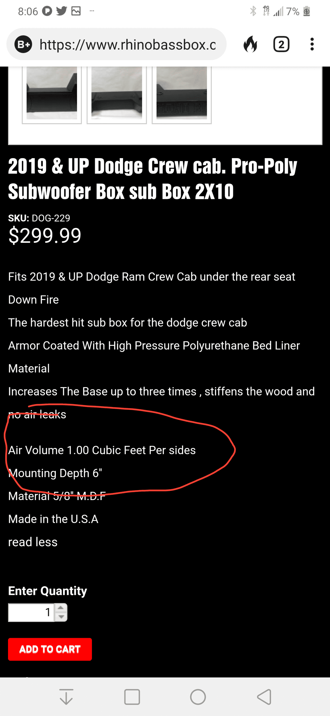

This is the box my nephew got.
This is one he was going to get but we were unsure of fitment.
View attachment 54103View attachment 54104
His enclosure looks a lot more like the SuperCrewSound enclosure. That said, I'd say getting this enclosure would be a better option than replacing the subs. That said, I'm pretty sure his bass isn't dropping out due to the enclosure, so he needs to hunt down the true source of his problem before taking any other steps.

While I don't entirely disagree, with the interior volume being off by 50%, says otherwise to me. Could be a combination of several factors. Especially when I think that JL is a little overreaching with their smallish recommendation on those 12's
