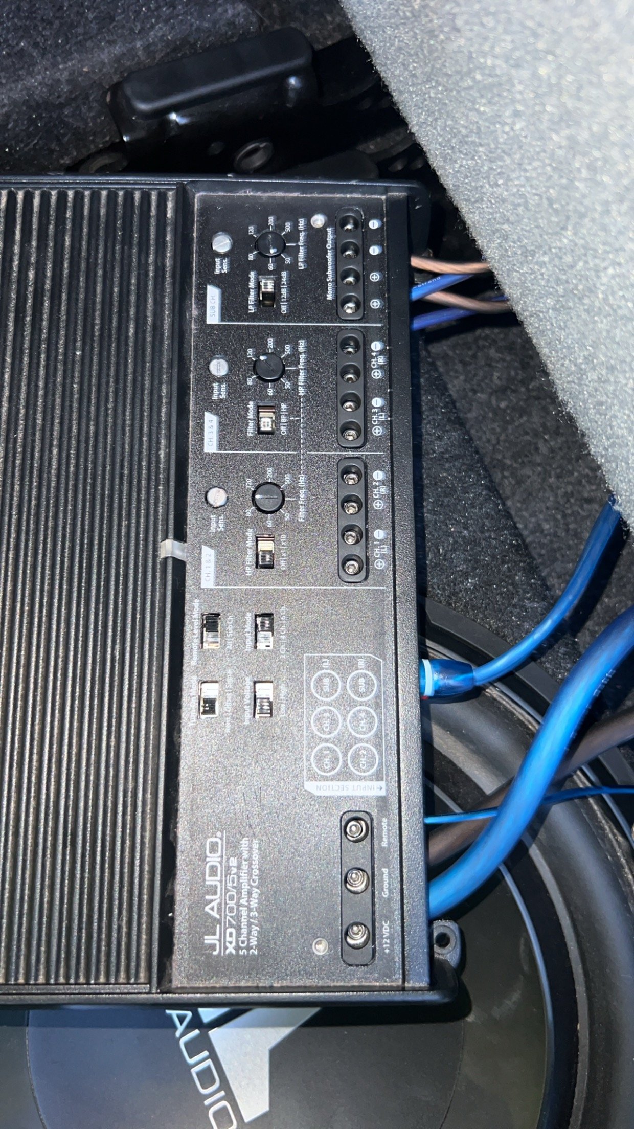

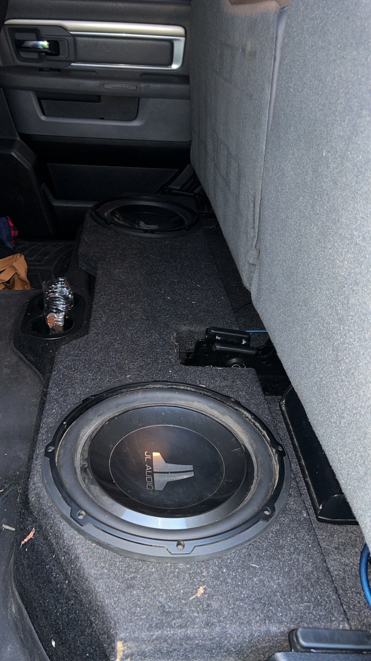

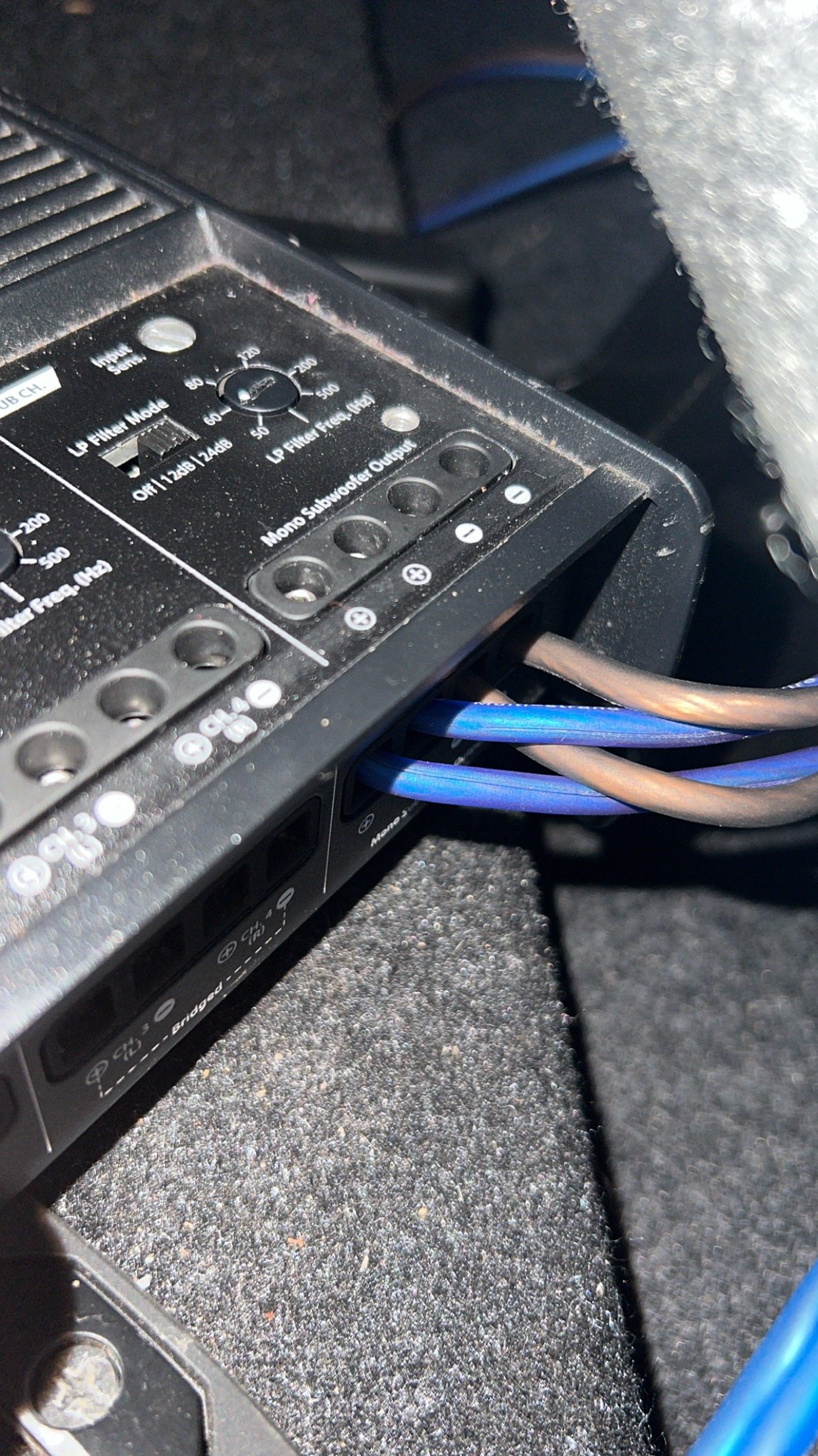

So just to be clear I am fairly new to car audio. I’m unclear on how ohms work and all this stuff. Just a dude that’s handy enough to install the parts.
I bought the speakers and box together used. It was a box specifically designed for my truck (ram 2500) to go under the seat. There are many boxes online very similar so it’s not a random or custom made box. I do not know the brand unfortunately.
Attached is a link for the speakers and a picture of the box and how I have the subs wired to the amp.

You need at least 2 cubic feet (2.2 for 2 of these twelves according to JL) and I'm guessing based on a 5-inch depth that you have about 1.5, if that. Do you have a link to the manufacturer or can you find out what the internal displacement is? Any documentation? a box that is 30-50 percent too small would definitely lead to issues, especially as the volume increases.

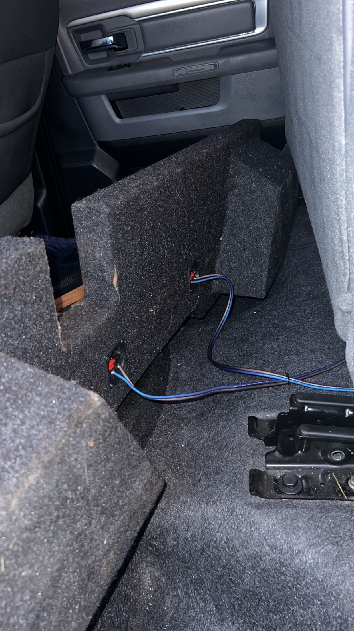

So there is no markings at all on the box and inside the box there is nothing other than cotton/insulation.
I did some research online and there are many versions of the ram 2500 under seat sub box. They are all around 1.00 cubic feet. Not much more. Skar actually makes a box just like mine that comes with 2 of their shallow depth 12’s in it. Can’t imagine they would push a product that would sound anywhere near the way mine does? I do get what you are saying but I’m confused why these manufactures would make a box that just doesn’t work with the speakers it’s made for. My subs are shallow depth so they’re supposed to be in a box like this.

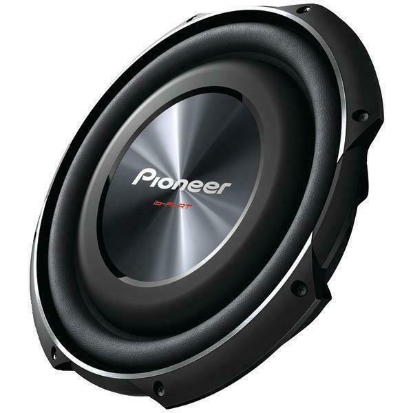

They are not JL's but in this box, they will most likely sound much better than what you have. These Pio's are a good fit at $129.99 each.

That said, I don't think the mismatch between the sub and the enclosure is the source of your problem. I'd guess the gain is set too high on the subwoofer channel. Maybe a bad coil.
Well, there is that. That JL is only feeding them 150 a side, not a lot so one may reach saturation pretty quickly, especially if the gains are set too high. But a pair of Shallow 10s or a decent set of 8's with a pound of Acousta stuff in that enclosure of 1.3 cu ft would fare much better. You and I know that the perception is that bigger is better... right?

My nephew has that type of box in his Ram. The thing has so many facets that it took me about an hour to calculate the volume of each chamber. I partitioned each chamber to 0.5 cu.ft. to load some SA10s. The box is 1 cube per chamber on the nose.
The 12w1v3 OP has use 1.25 cubes sealed, so the box is too small, hence the loss at higher volumes.

The box manufacturer only made the box to fit the vehicle. 1 sealed cube per sub is now becoming a common sub parameter for 12" subs, unfortunately your subs require more. Your options are to acquire subs that meet your box specs OR a box that meets your sub's specs. You can always sell either to fund the new gear.

All the Ram crewcab enclosures I looked up are ~.5 cuft per side. Looks to me like there is barely enough room for the basket and motor. That enclosure just screams 10" subs to me.
