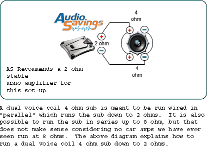

Just wire it up 2 ohm...no need for a different sub. If he is using 1 sub then a dual 4 ohm is a perfect match.
haha im not getting a different sub, switching out his d2.2 for d4.2 so I can get the most out of his amp.. Thanks for the parrllel wiring diagram though, saved me time from checking 12volt to be sure.. and that extra bit about 8 ohm.. I've read online that subs dont actually need break in points but most users on here say its necessary. If so, just keep the volume down and gain down or what?
