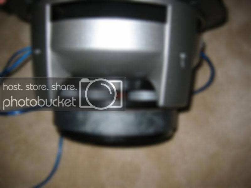

Just as an FYI, here is a pic of the PPI dual gap motor:
You can clearly see the two sets of magnets (the big obvious one, then the second ring of smaller magnets sandwiched between the two top plates) and two top plates.
