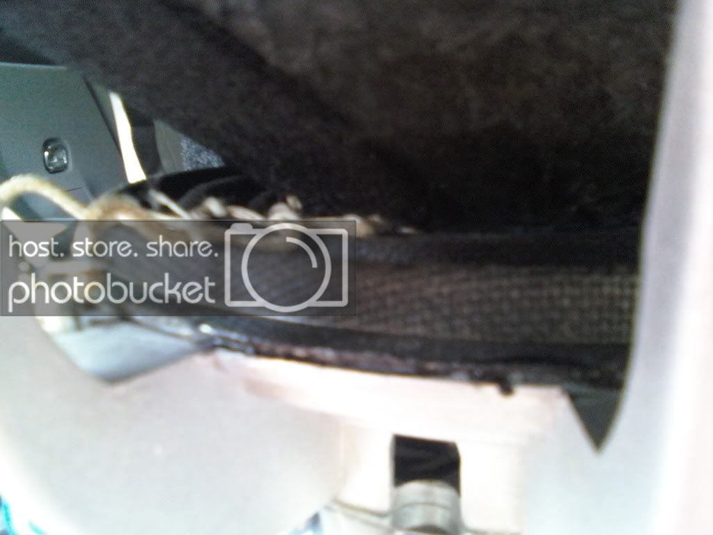

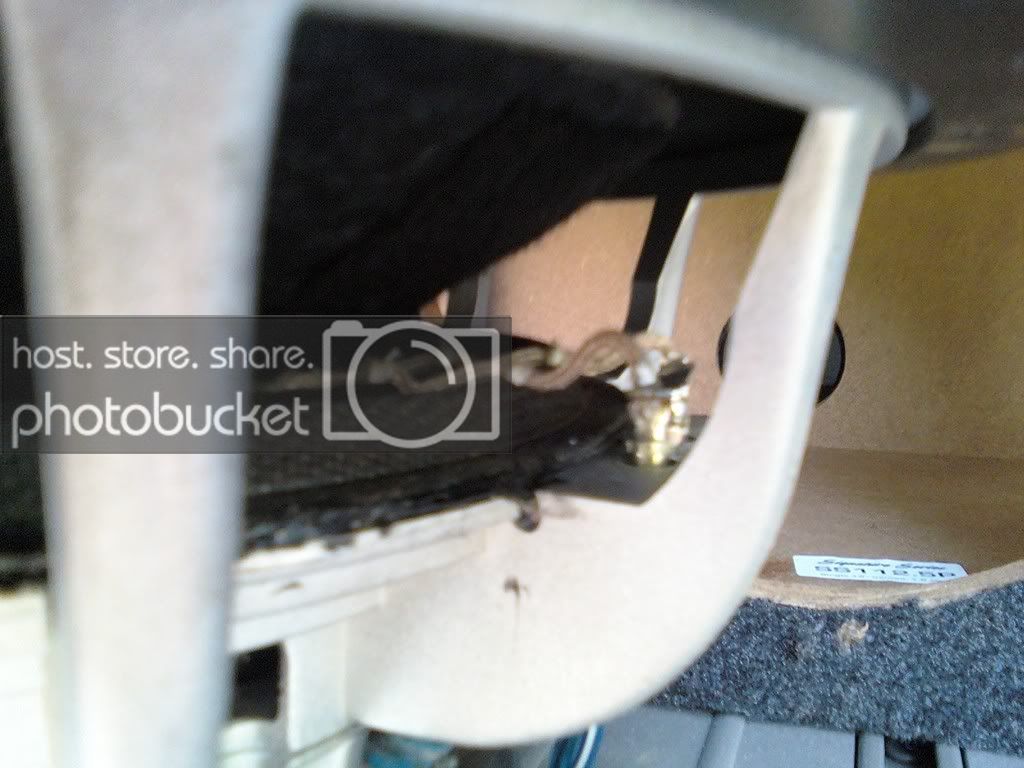

Post a pic of the tinsels if you could also.
Thanks Fusion freak, ill take a look at it tomorrow, and maybe take pictures and all.
