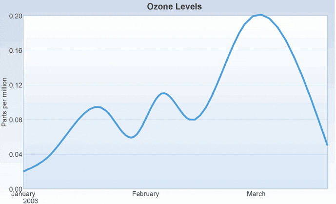

I don't have an image that shows a frequency response curve, so the following will have to be okay. Imagine that the y axis represents your gain(dB level), and the x axis represents the frequency range:
You don't want your subwoofer to peak at 55Hz and valley at 30Hz. It won't sound good.
