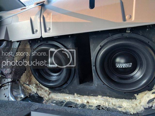

It works well if done right. I'm dropping my expensive customs and going with even more expensive x 12s because they work better for this type of setup. I'm breaking them in and can tell it's gonna be a lot louder. Got a local shop that's gonna build me a new setup like this. They said the Xs are very efficient and with 4k, he is almost guaranteeing me a 50.

I love those subs but I like my car to much to seal box to it like that.. if I could just have a box like 1/4" gap on side of opening then I'd like to do it but I'm not using spray foam or whatever on it

I all honesty, every loud car I've ever seen runs this setup or straight walled. I'm not gonna lie, it wasn't easy to just do that to my new car and seal it but I love bass and could have died in a wreck I was in last year, so I'mma do what I want while I can and spare no expense doing it. Hoping to have one of the loudest cars in the state when I'm done
