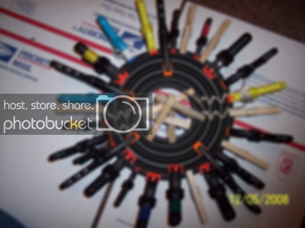

i have done a few recones and used as many as 6 spiders and never has a noise problem check ur glue joints and play it at low vol when its out of the box so u can figure out what the sound is...
I just glue around the outside edge and where the coil opening is and I have yet to have a problem. I clamp the crap out of if so the spiders stay as close as possible
IV TESTED THEM FREE AIR AT 26 HZ TREW 45 HZ NOTES MAYBE IM HEARING THING EACH JOINT I LET DRY FOR 24 HOURS
WHAT KINDA CLAMPS DID YOU USE ?DONT THEY STICK TO THE SPIDERS?
