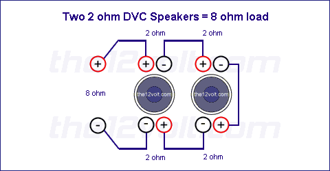

Ok so I have a question about the impedence of the set up I am thinking about doing. I have a set of kicker comp r dvc12 inch subs (2 ohm) and a 2500 watt class d 2 ohm mono amp. If I were them at 4 ohms a piece using the second coil this will create a 8 ohm load and would essentially make the amp produce 625 watts for each speaker correct?
Not sure exactly what your asking but here are your wiring options
The 8 ohm load will cut your amps power output back considerably

That's what I am trying to do exactly. The subs are rated at 1000 watts max a piece at 2 ohms and a 2500 watt amp at 2 ohms would deliver the full wattage so if my understanding is correct then a 4 ohm load will cut the watts in half to 1250 and a 8 ohm load will cut that in half again to 625. The subs are said to work best at around 500 watts so trying to get as close to that as possible with my limited options.

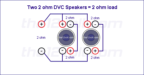

So if I'm understanding correct 2 ohms puts out 650 rms? So I would want to wire my subs in the 2 ohm configuration to get 650 watts to each speaker?

RMS is the figure your working with and that amp is 650@2ohms
Your best option is to wire the whole thing to a 2ohm load and that should give you 325 watts to each sub
