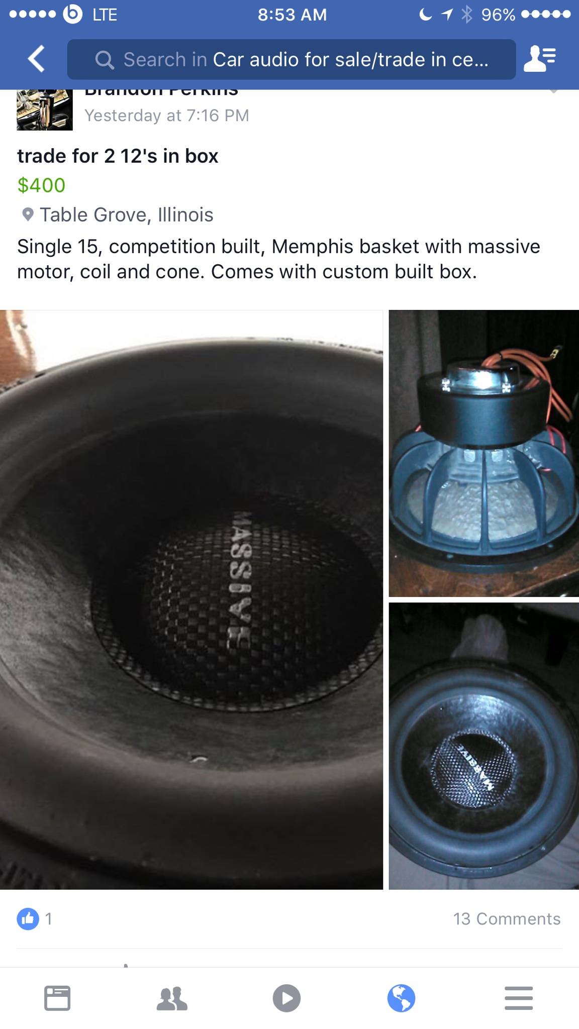

Well now I think I'm going to trade for a massive 15 or is that a dumb idea?
I wouldn't
Sa's are hard to beat as a sub and you would only be dropping cone area and higher ohm load unless it's d1 or quad2
If you need more output why not get 2 more and more power?
4 12's on 4K can get rowdy
