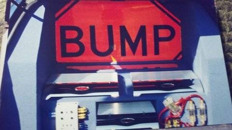

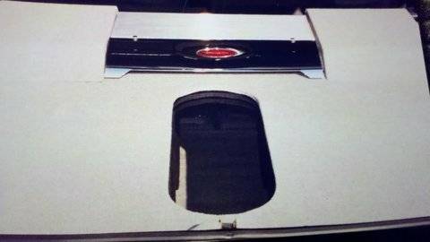

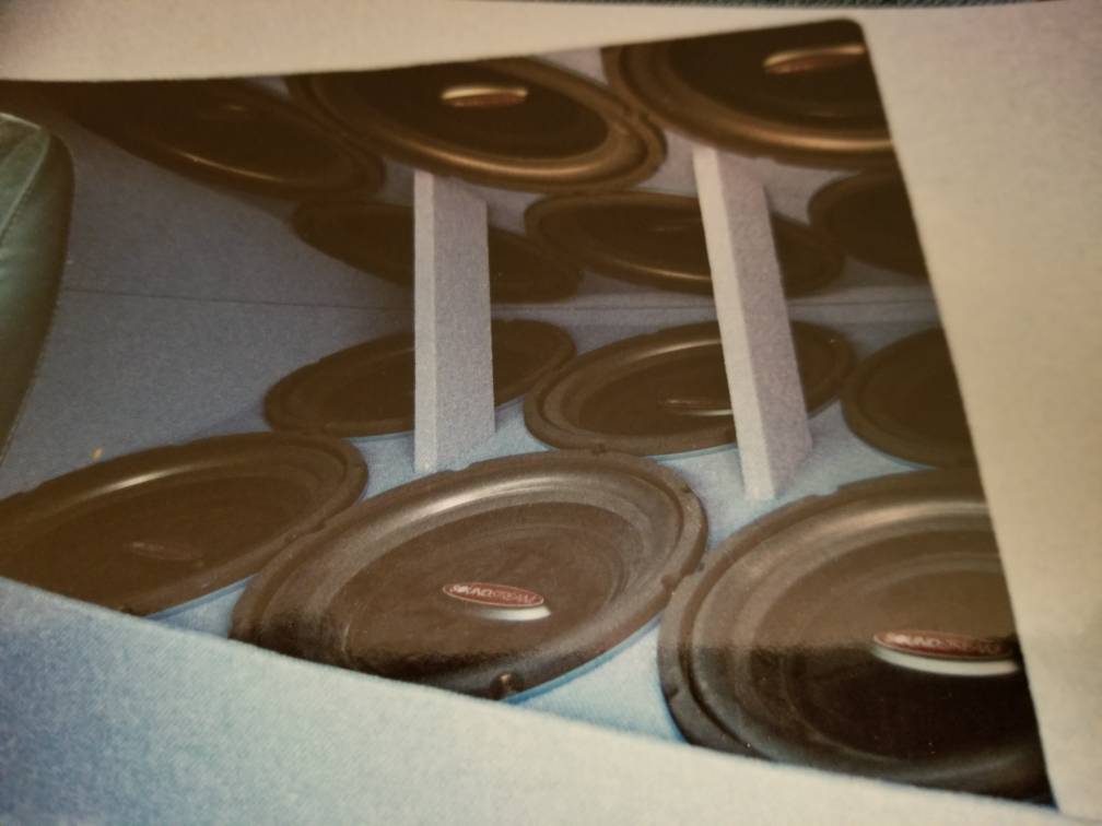

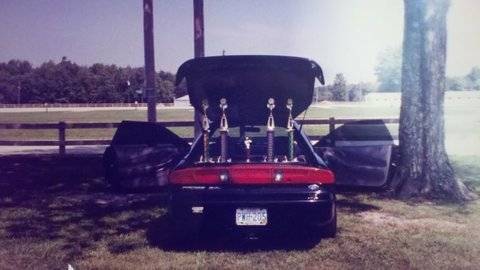

Just happened across some old pics of my loudest rig.
6 Soundstream Rubicon Subs (ran Mules and other Soundstream subs and the Rubicon were the loudest in my particular set up)
2 Soundstream 10.2 amps
Rubicon 4 channel powering Soundstream SPL components.
I ran all Xtant until I ended up sponsored by my local shop and Soundtream. Wish I had pics handy of the inside of the box and other amp racks/wiring.
Sent from my SM-G950U using Tapatalk

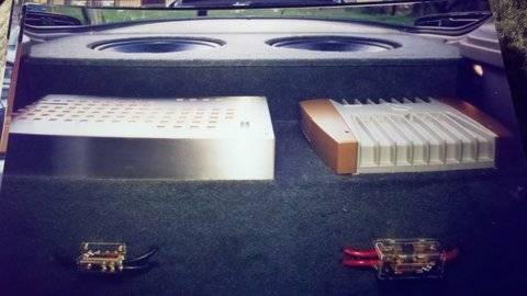

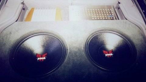

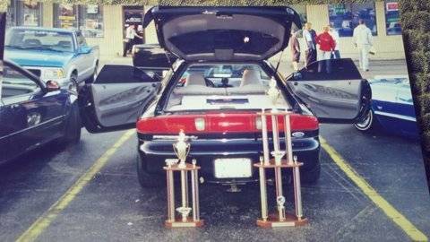

Couple other builds from back then...if you guys wanna see more I may be able to dig them up.
First "real" system I did. RF 15's in a different Probe GT.

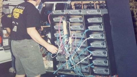

I'll see what I can dig up. Found this one on my Photobucket. We were competing at Finals in KC and someone was apparently pissed at this dude or just being punk kids....pulled almost all of his RCA's. It was a mess.

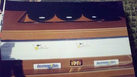

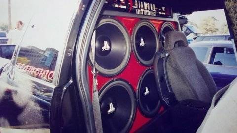

Some more of the guys I was competing against (none of these were my vehicles).
---------- Post added at 05:14 PM ---------- Previous post was at 05:13 PM ----------
Sorry about the quality but these are pics of pics from 1997.
