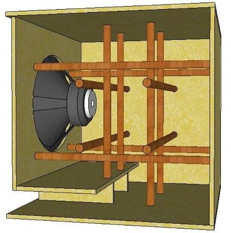

Dammit. I don't think I let it dry long enough. Is the baffle the front peice of the box the subs go into? If so I only have one. What are dowels and all thread?
Yes baffle is where you have the subs mounted.
Pretty sure the cracking is from weak structural integrity. Even if it is kicker, two 15s always need a double baffle or some form of bracing
Here's what dowels look like.

Thats the baffle flexing man. I could totally see the friggen thing flexing apart lol. As said before, I stand by that advice because thats exactly whats happening in the video.
Cool thank you. Should I add another baffle on the inside? Or dowels?
Should I take the whole box apart and put wood glue in between each peice?
yup. Add plenty of bracing wherever you feel is needed, as in any open flat and unsupported space. A stronger box = longer lasting and louder bass. This might raise your tuning a hertz or two, it shouldnt be a problem at all vs the gains you will get from a stronger box..
