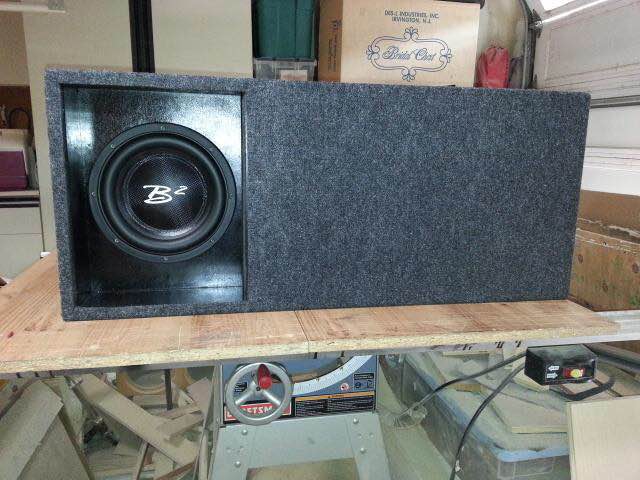

@Accord90 Tons of great advice in this thread so far that need to be considered. Sealed boxes are not the be all end all of SQ enclosures. I would only go sealed if I absolutely had no choice and I had plenty of power on tap that I'm willing to spend. I guarantee you a single sub ported in the right enclosure with let's say an idmax, which is one of my all time favorites growing up, will sound way nicer than dual subs sealed with same power. If you're looking for ultimate SQ, you need to look into specialty enclosures like a Transmission Line aka T-line boxes. This allows to get the most out of your sub in SQ. You'll be able to get the full spectrum of music and be able to hit any note instantly. It can keep up with fast double bass with absolutely no struggle and can hit as low as you want with no SS filter. Very balanced sound and flat for daaayyss compared to the almighty sealed box. The main downside is that it takes up your entire trunk space so you can only fit like a single 10". Doesn't require much power to get going either but can easily take all the power you can give it. The most versatile box I've ever had. Like many have said, it has less to do with the brand of sub you buy than what your overall system is gonna sound like in the end result. With that said, idmax, dayton ho, and icon for sure should be on the top of your list to consider. I owned the Fi Q before and though I really enjoyed it and was very smooth sounding, it was just too bottom heavy and was hard to blend in with certain music. Only good for rap music or slow decaf type of music. here's a pic of a T-line that I own. It's my favorite sounding box by far.
What size woofer is that in the t line and what's the net volume and tuned at
That's a 10" B2 Ref. For t-lines there is no net volume. It's just straight port all the way through. Mines tuned at 28 hz. T-lines are supposed to be tuned close to the FS of the driver. With subs that have a higher FS, you can be tuned much higher than that and surprisingly hit all the lows without unloading.
That looks like a pretty big one due to the tune... bet it digs awfully deep.
They say a higher Fs driver can still get low really well and be "Sq-ish" .

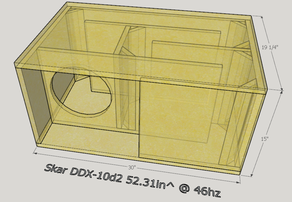

I drew-up a budget option that handles some power and is much smaller I believe...
Even though its tuned very high it will still dig deep into low 30s?
