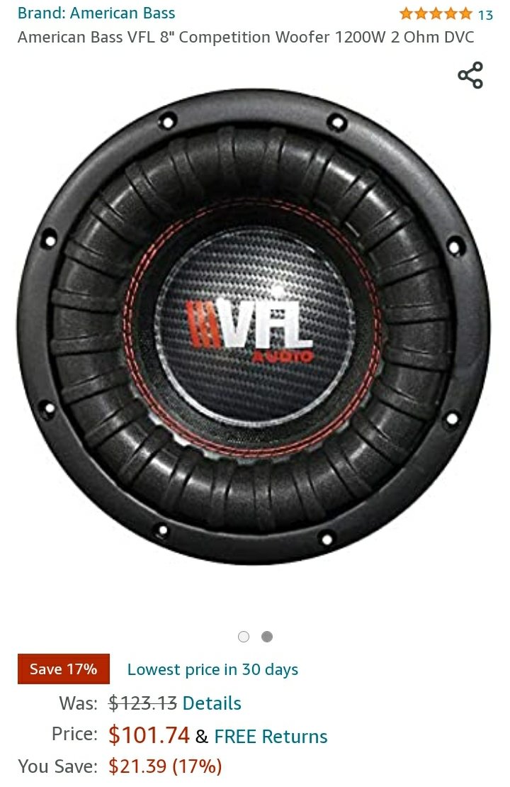

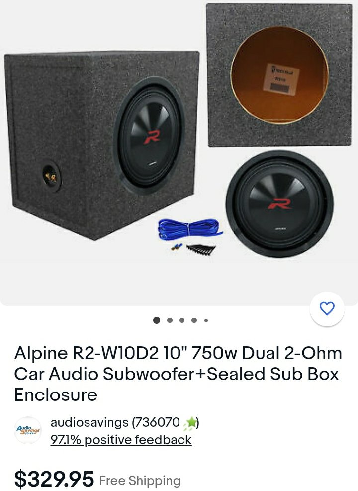

These two are also good options and budget friendly. I'm currently running 4 of the VFL's on a 3,500 watt Sundown amp.

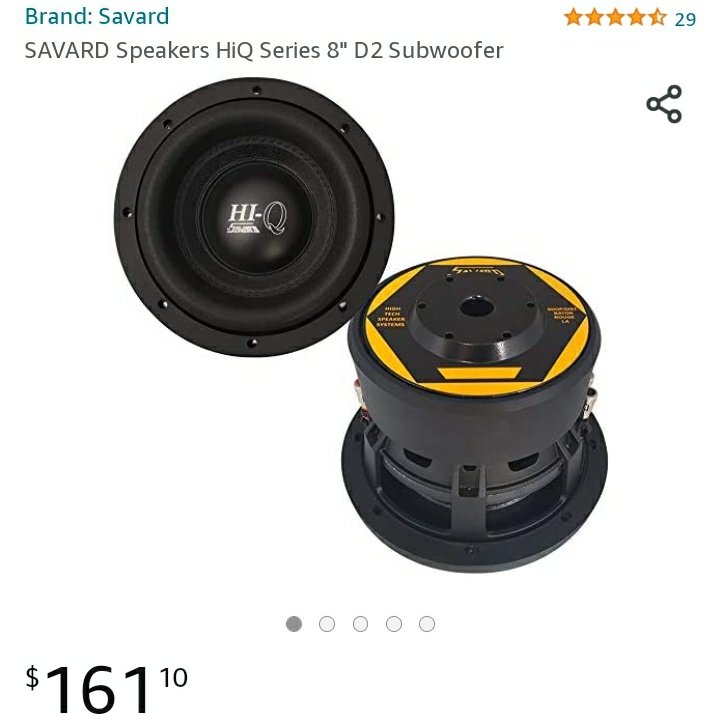

How are these?
The build is ok on the ultimax. That rattle sound is when it’s overdriven, probably in a ported enclosure. If you’re going to get Savard, I would stick to the hi-q line. The rap line is their lower end stuff.
