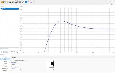

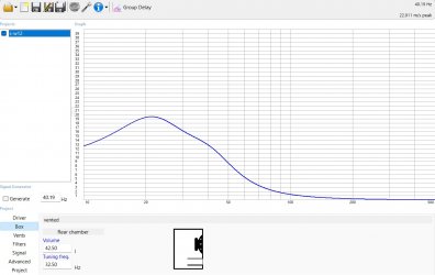

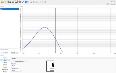

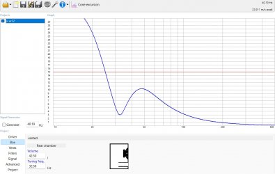

i want to build a box for Alpine S-W12D4 subwoofer
i model the box in WinIsd and here are Graphs
my amplifire output is 560 watt rms at 2 ohms 14.4 so probably it can deiver about 450 watt rms at 13.8 volts where i want drive my subwoofer at.
i should notice a can't use larger box in my car(maxium volume i can use is 43 liter)
so is that a good design for SQ purpose?any idea for a better design?
