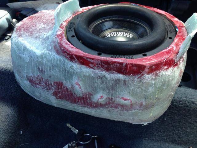

Go for it. Working with fiberglass isn't as difficult as it seems. This was my first attempt at building an enclosure with fiberglass...
Here's the build thread...

Hey! that look pretty good! Here are some questions I have. You don't have to answer all of them as it's just me typing everything I'm thinking : p. How does it sound, and is the sub you used an 8in? Does a fiber glass enclosure of that size provide enough volume for your sub? If my fiberglass box is fairly small because I am building inside a tire, would it be a good idea to use polyfill? I really appreciate the help and sorry for all of the questions. I am new to car audio and although I have read a lot on it, I have not asked for people's opinions on the things that I have read on.
It sounds great. Those little 8s pound pretty hard especially in the tiny cab of my Toyota. It's pretty much the exact volume recommended by Sundown for that sub. I did the packing peanut method to figure the volume. Definitely use polyfill if your enclosure is going to be smaller than recommended for your sub.
