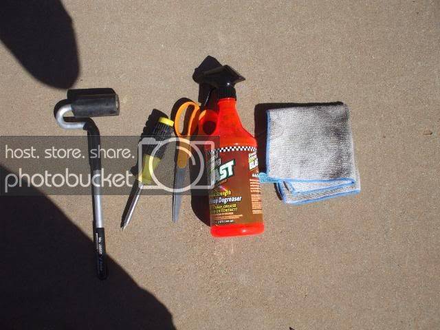

where can I get a roller and how much?
I bought mine from Lowes hardware store. Its originally made for laying down floors or something like that lol:
