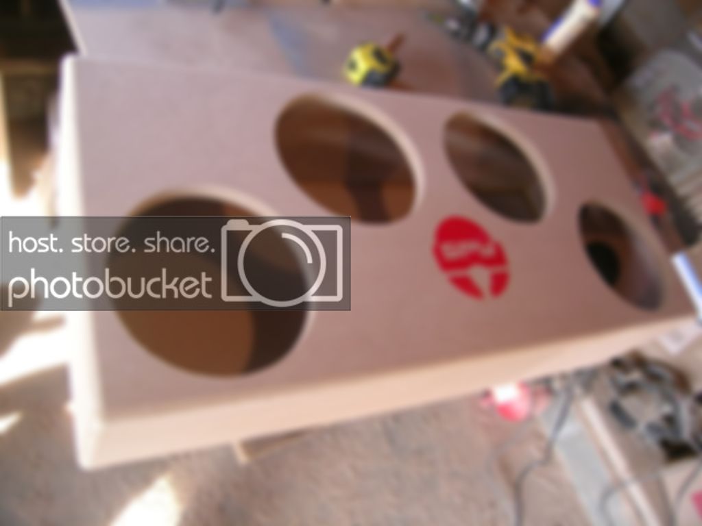

I have 4 Sundown E8s that I want a simple carpeted sealed enclosure built for. I am in Stockton M-Th and the East Bay Area on the weekends. Anyone up to it? Sundown recommends .28 ft^3 per sub, so total 1.2 cubes? I want one terminal cup so they can be wired down to 1ohm. I'd also like them flush mounted but not necessary if it will drive the cost up...Who can help me out? Thanks!

Here is one I built for 4 e8's a couple of weeks ago.

Hey if no one's able to do it, I can probably do it for the cost of the sheet of MDF (I still have extra glue and all that left over). But it won't look super good LOL. I'll probably get the cuts from home depot go home glue and staple it together then use triangle braces. Then idk how you want to run the speaker wire..
Haha well we'll see. Can you do roundovers? And I was told for sealed to not use a common chamber for 4 sub, but I don't know why. I want one terminal cup to wire them down to 1ohm. Can you carpet too? We could build it together and learn? LOL...
I can't think of a way to run them to 4 individual sealed chambers down to 1 terminal cup. If you're mounting all 4 subs same way then I don't see why a common chamber won't work. But if you're thinking about mounting 2 rear firing and 2 up firing then i can see why. Round overs will need a router and that I don't have. Carpet is EZ you can buy it at JoAnns and use 3M spray and carpet but I haven't done 1 carpet that i was proud of. I think that RL-p box was my best carpeted box.

I'm thinking how your box will fit in.
H: Max 10"
W: something like 1.5" + 8 + .75 + 8 + .75 + 8 + .75 + 8 + 1.5 comes out to 38"..that's mounting the subs straight across ..how's that gonna work? haha
