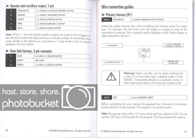

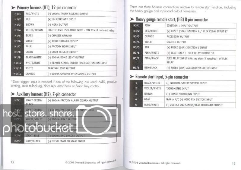

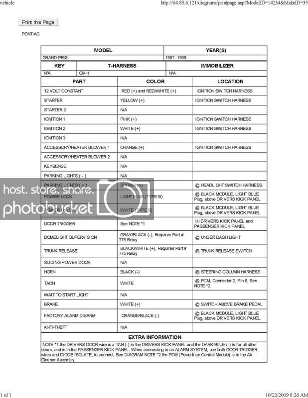

Hey guys im having a tough time installing my new Viper 5301 i just picked up.. To be honest with you i thought it was going to be alot easier than it is.. for the simple reason that it is just a generic wiring layout.. not specific for my car wtf i cant figure this out?! could someone help me out and tell me what wires go where, they are definitely not color coordinated that's for sure..
