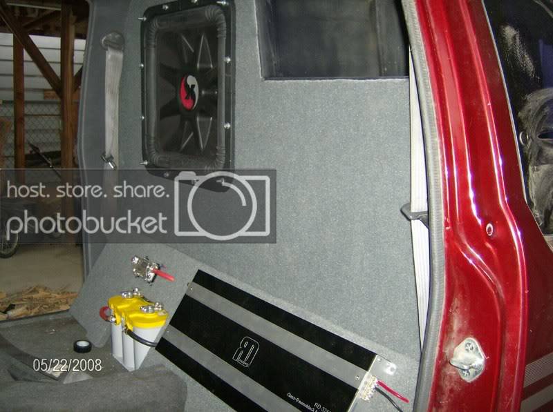

I had a solox 18 walled in a 1989 toyota x-cab. It was 10 cu. ft. tuned to 35 hz I think thats what kicker recomeded too. My box was 1 1/2" thick all around and a couple peices of all-thred for bracing.
