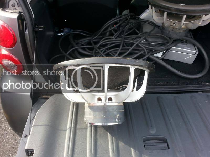

so ill start with the subwoofer i use to have a 15" subwoofer in my reg cab sierra i had an really missed that super low bass and such you get with a 15" . i had found on local classifieds kiiji a RE audio SE15 for 100 bucks so got it while i could

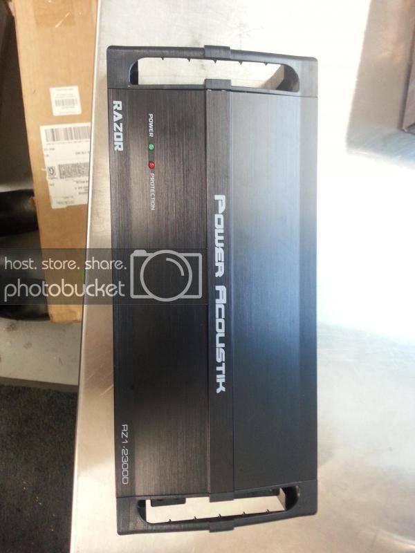

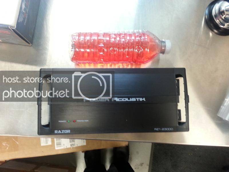

next i had to find an amplifier which was effiecent enough,powerful, and in my budget . this turned out to be harder then i had thought alot of time went into it and figuring just how many amps i could use i figured realistically 50 amps was tops i could ever draw the lower the better. the Taramps HD800 was ideal choice but alittle above price range for now. so i finally picked something small effiecent and well cheaper, alot of people are probably going to talk **** about amp but i ended up getting a power acoustik Razer RZ-2300 now obviously i know this amp would never do anywhere close to 2300 watts or even 1000 . i am figuring honest numbers probably around 6-700 rms. i have owned these amps and despite it now being big brand new you can beat the **** out of it and it will keep going and still sound decent .

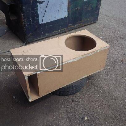

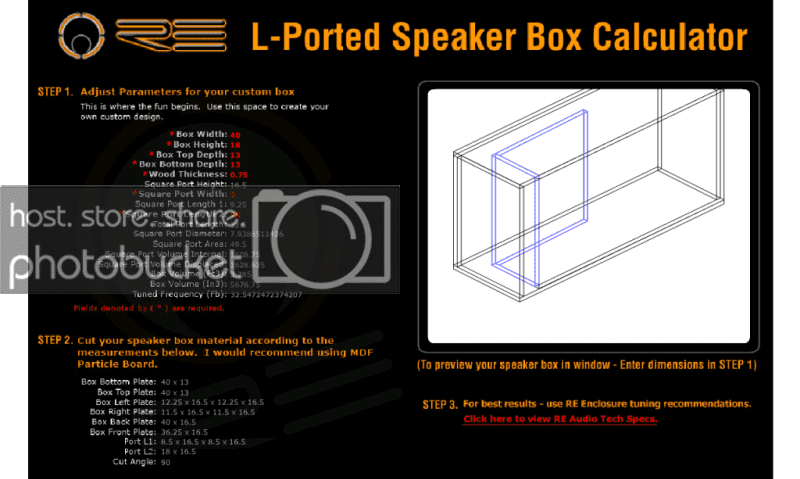

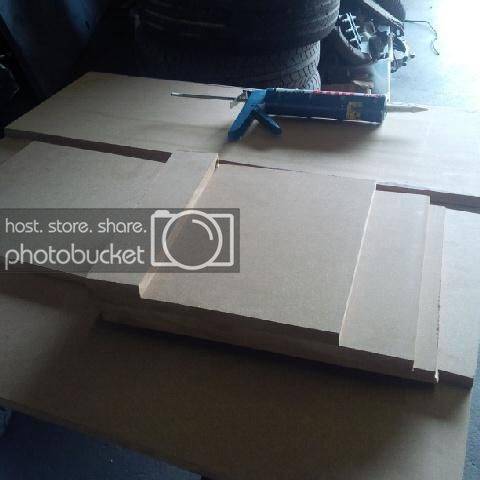

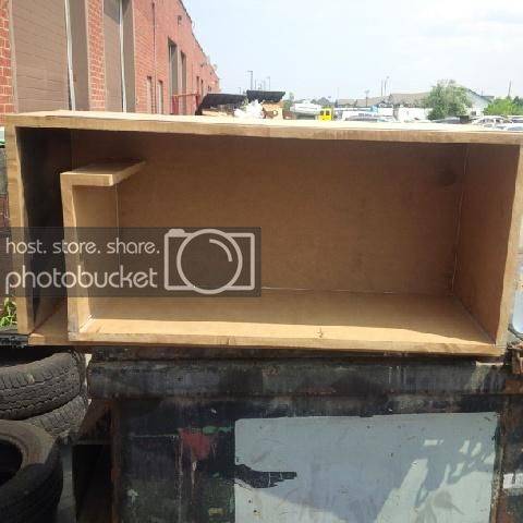

next was time to make the subwoofer box , my buddy derrick helped me make it and really pulled through. we ended up building a custom subwoofer box 3.3cu ft at around 32 hz.

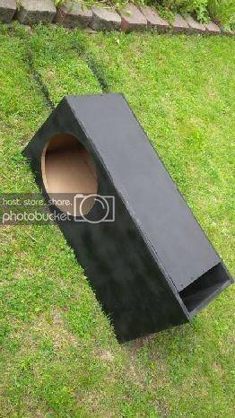

just quick paint looks not so great going to custom vinly wrap it though

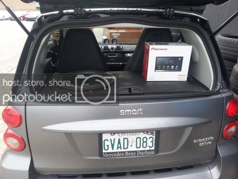

and inside the car with subwoofer in box
the Dvd deck well i went through two first one was a pioneer APPradio which turned out to be a pain in the *** to do anything with as i still use my old classic ipod and such so i wired in a pioneer AVH-2400BT DVD deck all i really need.

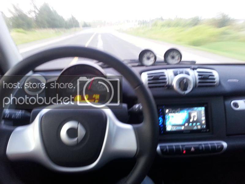

picture is blurry will get a good video up later on the flex as it sounds unreal loud in that car . and my range was not affected by even 2 km's
