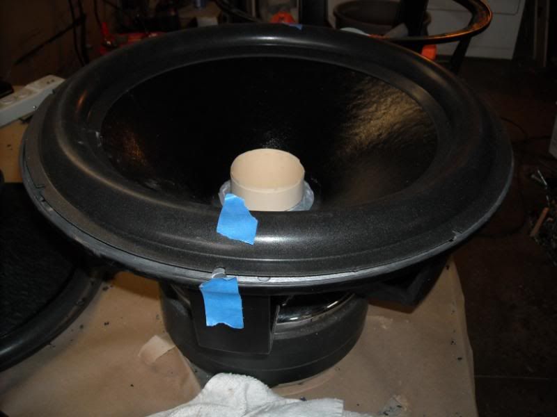

Here's a write up I did on another site.
http://www.stevemeadedesigns.com/board/index.php?showtopic=33737
