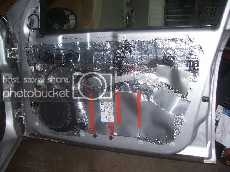

i use sheet metal, pop rivets, and silicone. Just make sure there is nothing you want to do inside the door before you close it up like JimJ said.

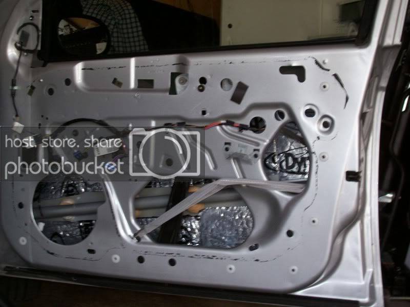

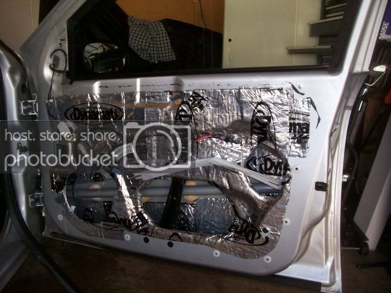

on my car it was impossible to seal up the entire door skin due to moving parts. first i put as much of a layer as i could on the outside inner skin.
then i coated the inside inner in a layer
then i went back to cover up as many of the holes as i could. i thought about using mdf but my door trim panel actually sticks out into the door itself on the big opening on the bottom. i ended up buying a roll of roof flashing (thin metal) and used self taping screws to hold it to the door. then i covered that with another layer of dynomat. this pic doesn't really show it but i had to go back with a wooden mallet and bang the form into the flashing / dynomat pieces so the trim panel would go back on.

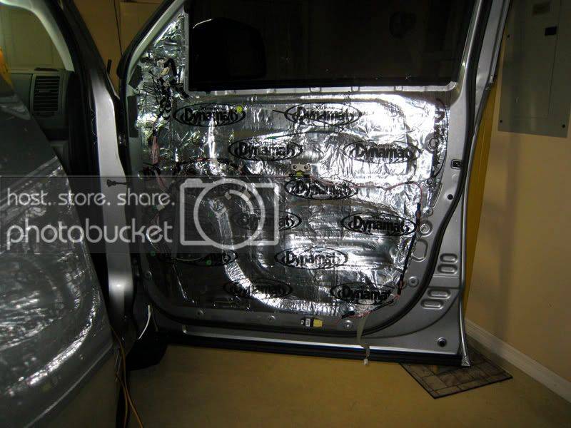

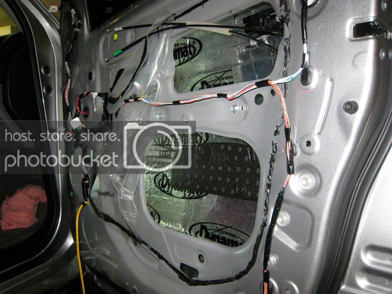

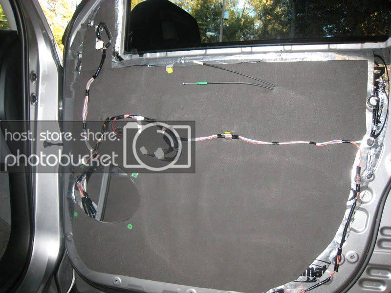

I did my entire outer door with Dynamat.
Then I covered the entire inner door with another layer.
After that I gave both the outer and inner layer a coat of Ensolite.
The rest of the interior got the same treatment. I would say do as much deadening as you can afford.... the more the better. Do it in phases if you have to, that helps ease the pain a little.
I didnt cover the holes in my doors with MDF, maybe I should have but its sealed up pretty good between the Dynamat and Ensolite.
