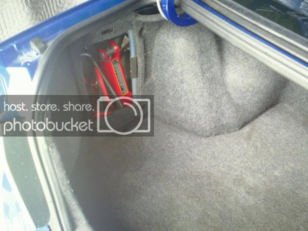

Where can I put second battery, so I can watch a movie with out having a car on/running. Is optima red top has enough juice to last a single movie?
Plan on doing big 3 upgrade soon.
I want keep the trunk clean as possible. Spare tire well is out of option.

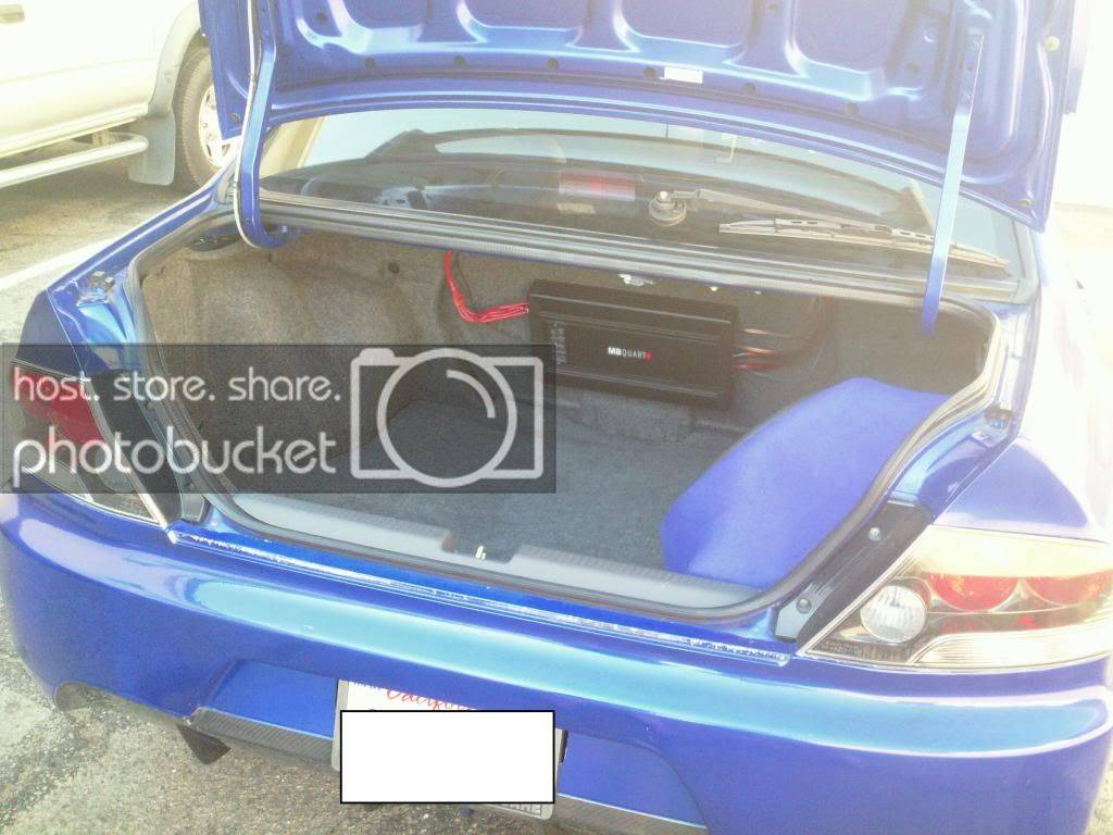

Left side

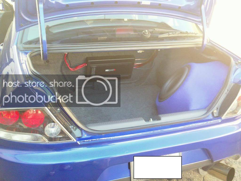

Right side
left side ,build a small mdf box with matching carpet to match the trunk ,you can even enclose the battery box to make it look cleaner
I will still need to access to my tools stuff in side wall
the box is to house the battery and to make it look stock for the most part .put heavy duty vel cro on the bottom so that it sticks to the carpet ,but so that the battery box can be moved if need be .
Have you ever considered making a fake floor. You can hide the battery in there, place it sideways...and still have access to your spare. I'm building a fake wall in mine...where I can still pull up the floor to get to my spare...in case if anything happens...as well as access to my battery...which is in the trunk as well. My batteries are going to be hidden behind the wall..since it's only like 3.5in depth.. I got the xspower xp750s...small batteries. But yes, Optima did my justice when I ran 2,000rms off it. Never seen light dims and held a charge for a long time.
...say can that red top fit in between the gas well and the back of the seat on the left side...if so..just make a wall in there to hide it...since you never will need that space..
