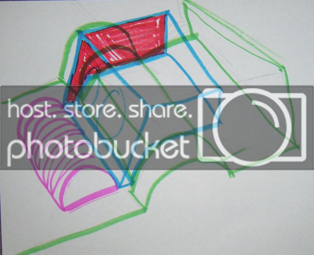

I know your car has a trunk, I will draw up a pix in a second n post it.
I appreciate the drawing, however it wouldnt work like that...My trunk has the shelf for the spare tire if that makes sense...I can post pics tomorrow of what i got to work with and see what you guys think
alright, lets try again.
this time - the red color area is like a side view of your pasanger side of the box.
is how it could maby fit around that hump for the rear .
mj's a pair want about 10 cubes - wich is a lot of space. so build the box as big as possible
and reasonable. you will be happier. my box for single 18" sub is small - n I dont like it much.
you would probly have to build it in the car, but is definately a sick *** way to do a box.
and still have ppl be able to sit in rear seat...... kinda....
but this way - your not wasting any sub in the trunk.
you wana hear it. and be loud as possible.
this way the sub is in the cabbin, but using trunk space for the box.
so most of the sound is going to go right in to the cabbin where you hear it.
expecially if you port it up - so it bounces off the rear glass.
more ghetto drawing. hahaha.
