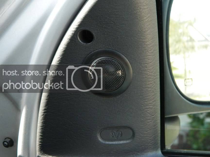

Do i have a good reason to move then or do you think there fine up there? I believe of i move them, im going to put them on the door like this or possibly on top but same spot. Basically same location but i dont to cut the hole out for the tweet. I considered spheres but i dont want to drill holes in my pillar
I moved my tweeters off the dash firing into the windshield in my 2004 Honda Pilot. Moved them on the door panel about 8" on top off the mid and it really made a big difference in the sound, really seamless sounding and got rid of the reflection. You have to decide on what kind of "damage" you want to do with your vehicle, cut a hole in door panel or drill a hole in A-pillar for a sphere. Experiment with many different locations first, drive with them in one spot for awhile, then put them somewhere else. It really depends on the amount of time and effort you want to dedicate to your install.

That makes sense, i think im going to double sided tape them there and if i like it ill cut the hole. Not sure how i could test the sphere position lol
