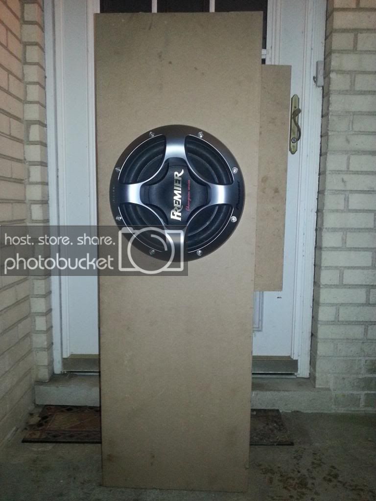

I was able to fit a 12" Pioneer champion sub (Dual 2 ohm 400 rms / 1200 peak) that requires a 6-1/2" mounting depth in a custom built ported box tuned to 36 hz with around 1.8 cu ft. net behind the seat of a 96 F-250 for one of my buddies - Feeding it 500w rms @ 4 ohms off of an older kenwood amp (VERY budget system LOL) and it sounds pretty fkn good ;-) - It's: 48.5" W x 15.5" H x 8.75" D1 & 5.75" D2 - Port firing out the top pass side.
Pic:
