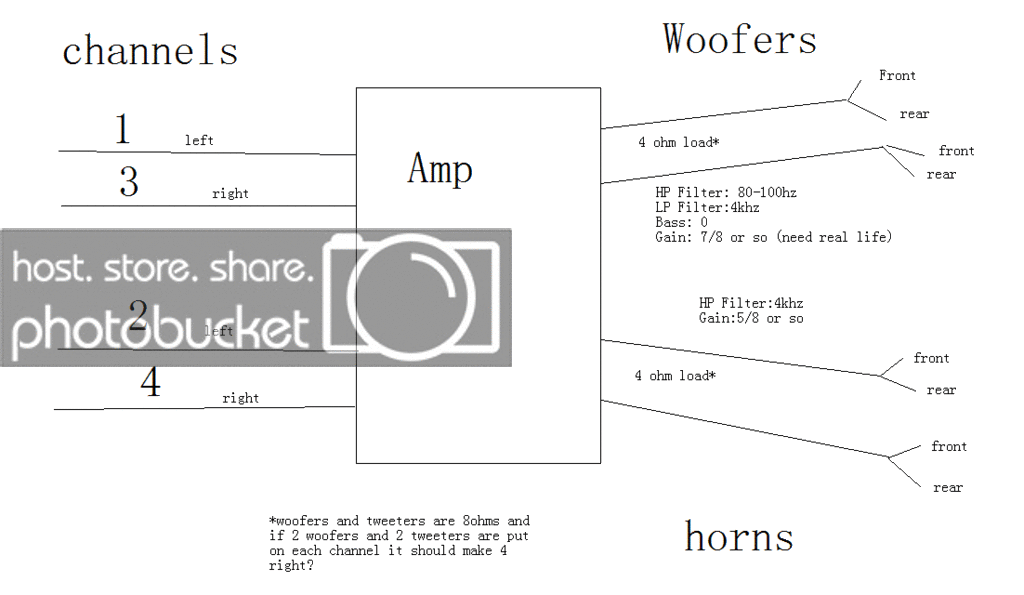

i need some opinions on how to set this up efficiently and loud
i will be running these http://www.parts-express.com/pe/showdetl.cfm?Partnumber=264-422 in the doors off of my XI olympus.
i want to put the 4 in all the doors left side on channel 1 and right side on 3 which on the amp gains and crossovers are set. bout 6/7 gain and 80-100 highpass?
for the high setup i want to run these http://www.parts-express.com/pe/showdetl.cfm?Partnumber=264-362
again 4 of these in the front pillars and rear pillars, channel 2 left and 4 right.
these are my questions, would i want to run a normal passive crossover, a audio control linedriver/eq/crossover, or would setting the crossover on my amp to 4khz work? parts express says 5 but im just kinda confused.
DIAGRAM ADDED
I have the selenium 6 1/2's with a set of pioneer 6 1/2's running on the same channel. It gives me the mids and the highs at the same time.
Also my rear stage I have a pair of selenium 10's with some super dome tweeters, they sound amazing also.
