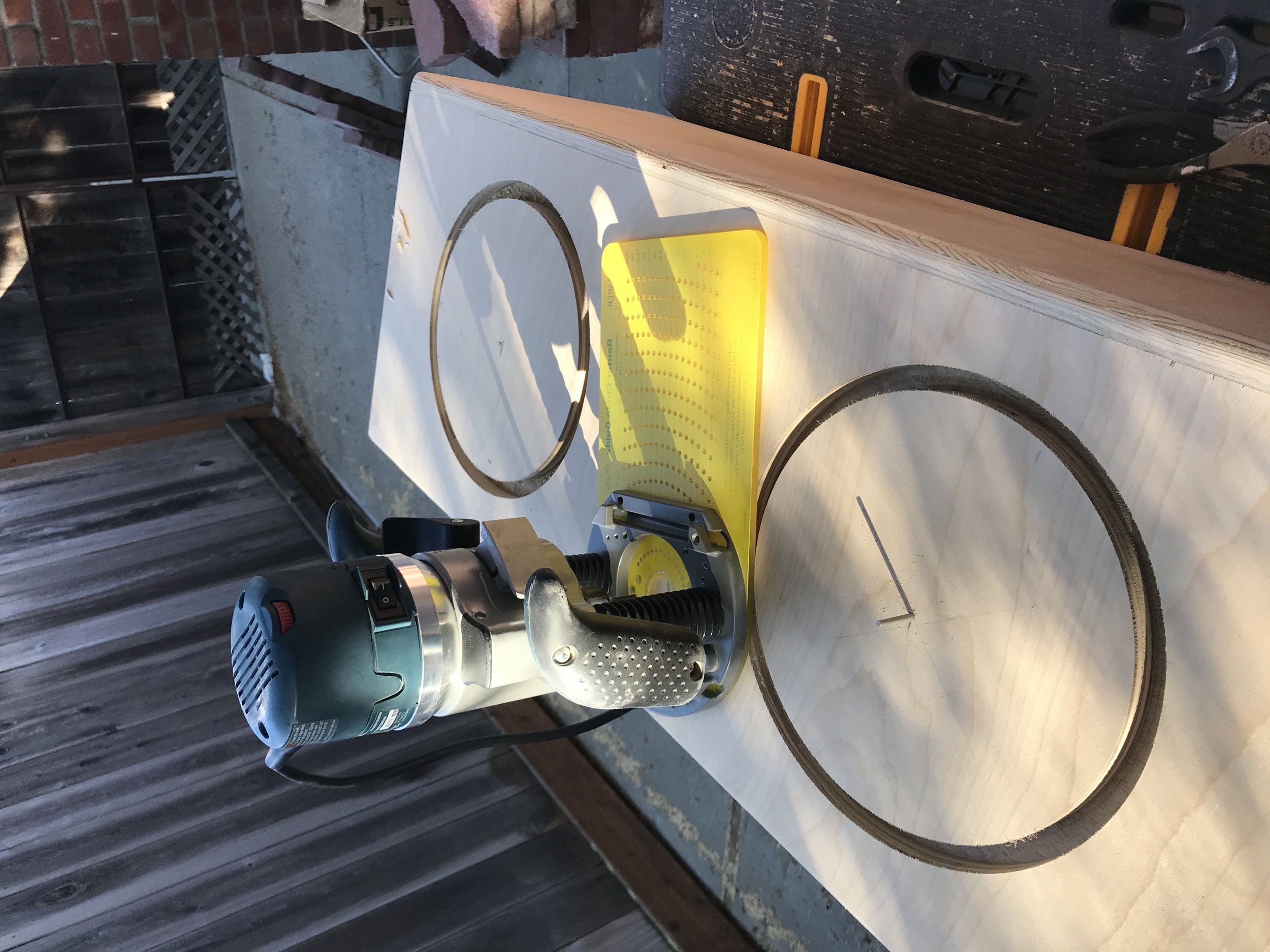

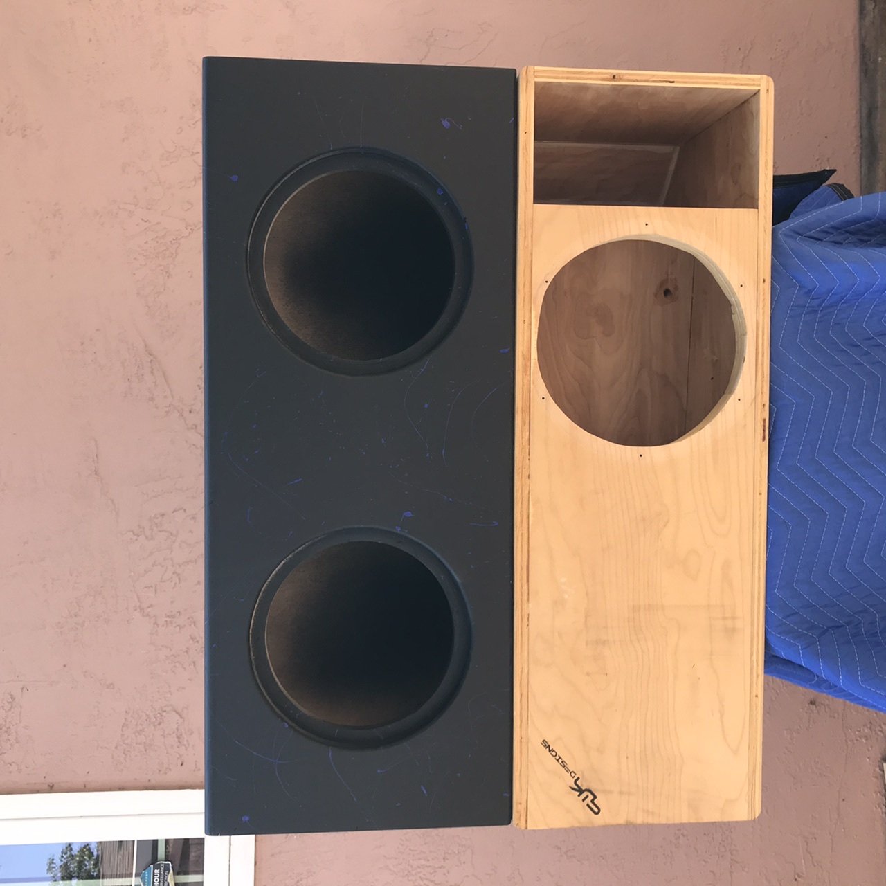

Happy with the box so far, def blends better with the midrange and pretty good linear response as expected from a sealed. Roughly 3 cube net

Just an Update and Review.
# Sealed
the subs take all the 2000 ish watts I presume and will start to complain and heat up at the very max level. They hit pretty clean and accurate, noticeable hump in the 50 hz region and dip in the 70 hz. These are DDs SQ range of subs so I was curious to try them out and they get loud and perform well in sealed; however, they still cannot compete with my Morel ultimo in terms of detail and accuracy. This even when Morel is in a horn enclosure and not a sealed box.
# Ported
Built a Ported box per DD specs 3 cubes net with 31 hz tune and 48 sq in of port area, it def was louder than the sealed but not mind blowing loud nor more accurate. Many claim that ported is accurate and can generate great SQ but in this case it was not very good for my listening, it lacked some detail that the sealed box had and just sounded slightly muddled even at lower listening levels.
So is this SQ? maybe for some, just not for me and I'd rather go with a tried and true SQ sub over these such as Jl w6, audiofrog gs, morel ultimo, etc.
