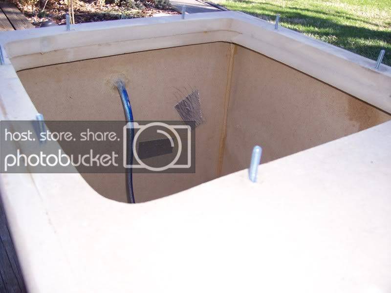

I've only done this to one box, but am still very happy with the outcome. I drilled the hole quite small and threaded bolts into the mdf.
Yes, t-nuts can back out...but cover them in jb weld before hammering them in and see if they back-out after drying //content.invisioncic.com/y282845/emoticons/wink.gif.608e3ea05f1a9f98611af0861652f8fb.gif (yes, jb weld sticks to mdf very well)
