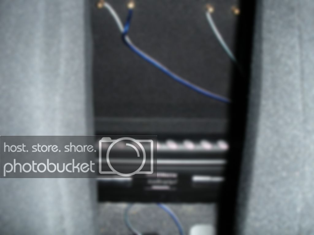

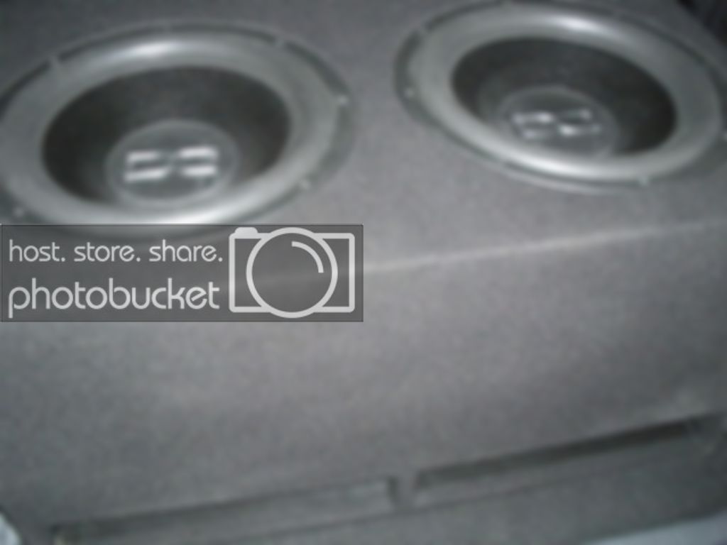

Here are some pics of my Sub amp mounting and my rear floor carpeted.

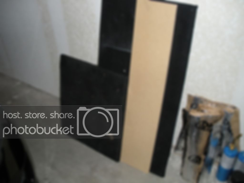

Carpeting

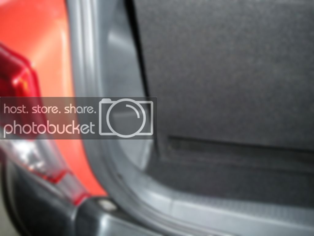

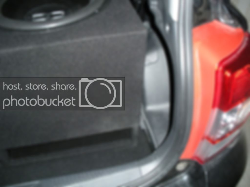

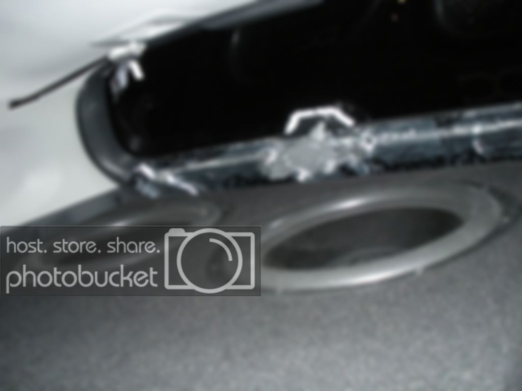

Shot of the rear window clearance ( still need to put my rear hatch panel back on)

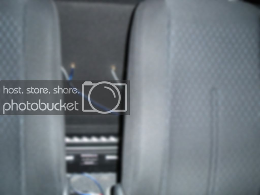

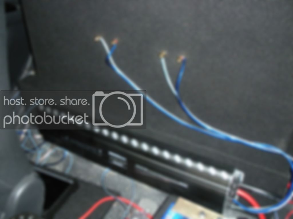

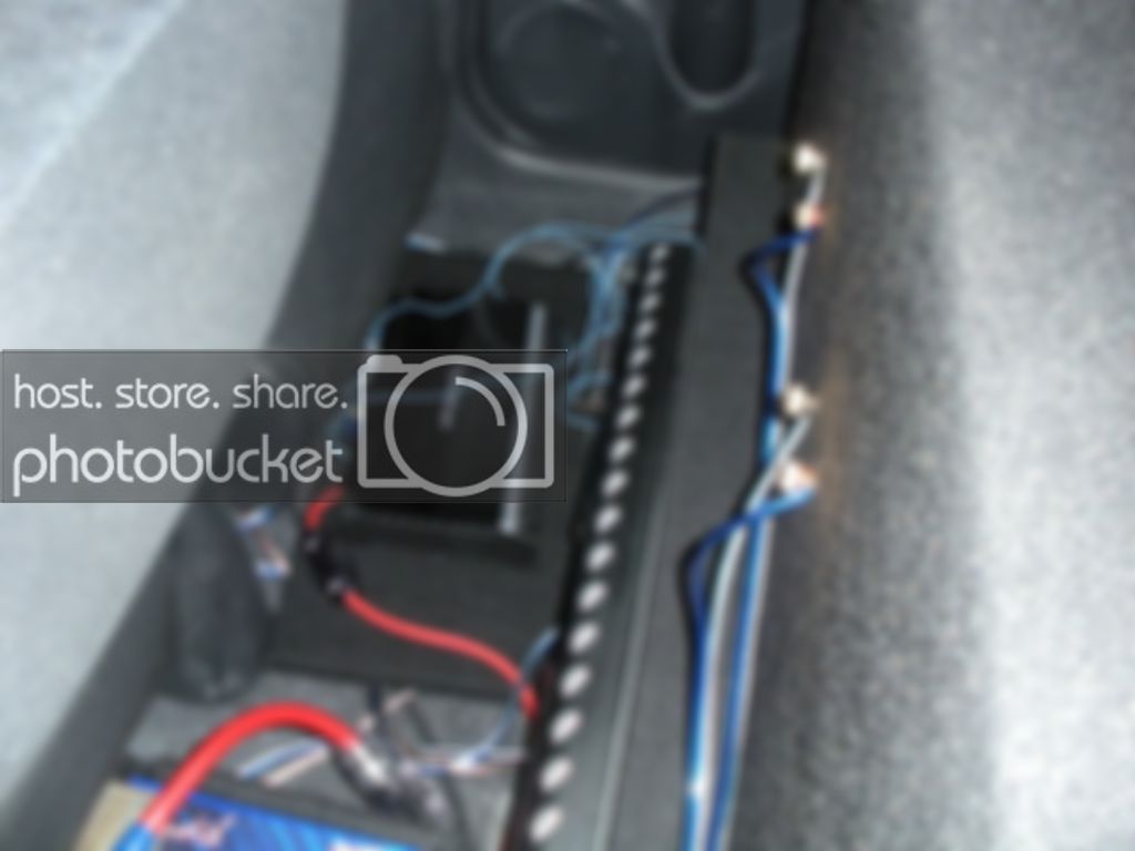

Sub amp mounting (the sub amp is mounted on a board attached to my false floor and not to the actual sub enclosure.

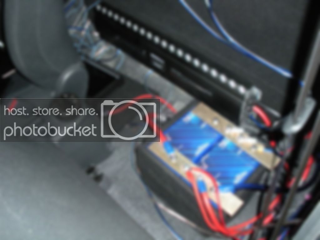

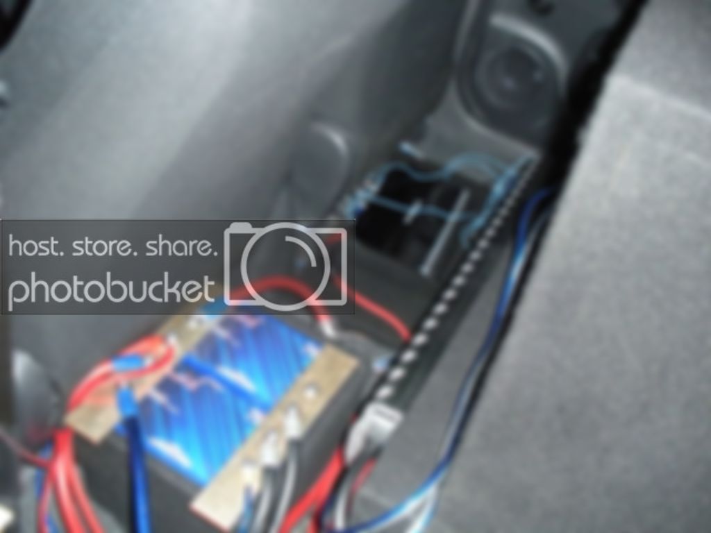

Pics of my batteries and wires before amp rack (I should say table) and wire management.
Basically I plan on making a carpeted box table that will stretch the length of area I have to work with holes on the surface so I can run wire through and hide the brunt of them within the box table. the batteries will be recessed into the table. I might invert the subs just to see how it sounds for fun and I really like how the subs look. very shiny. I have always been curious as to how it sounds though. Anyway, I was curious to see if all my stuff worked.

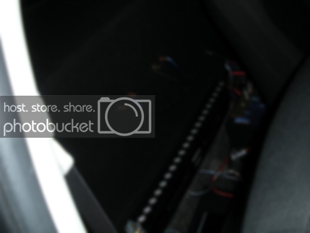

It was late and dark outside, so the pictures arent the greatest plus my car is dirty atm. will get some better pics tomorrow.
BTW, I was a bit skeptical as to the performance of the AP30001D before I received it, but **** the amp is beast. I currently have the amp running 2 ohm bridged. Plan on going 1 ohm when I build my rack and run better speaker wire.

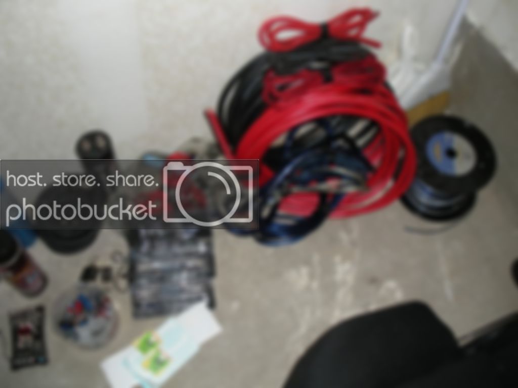

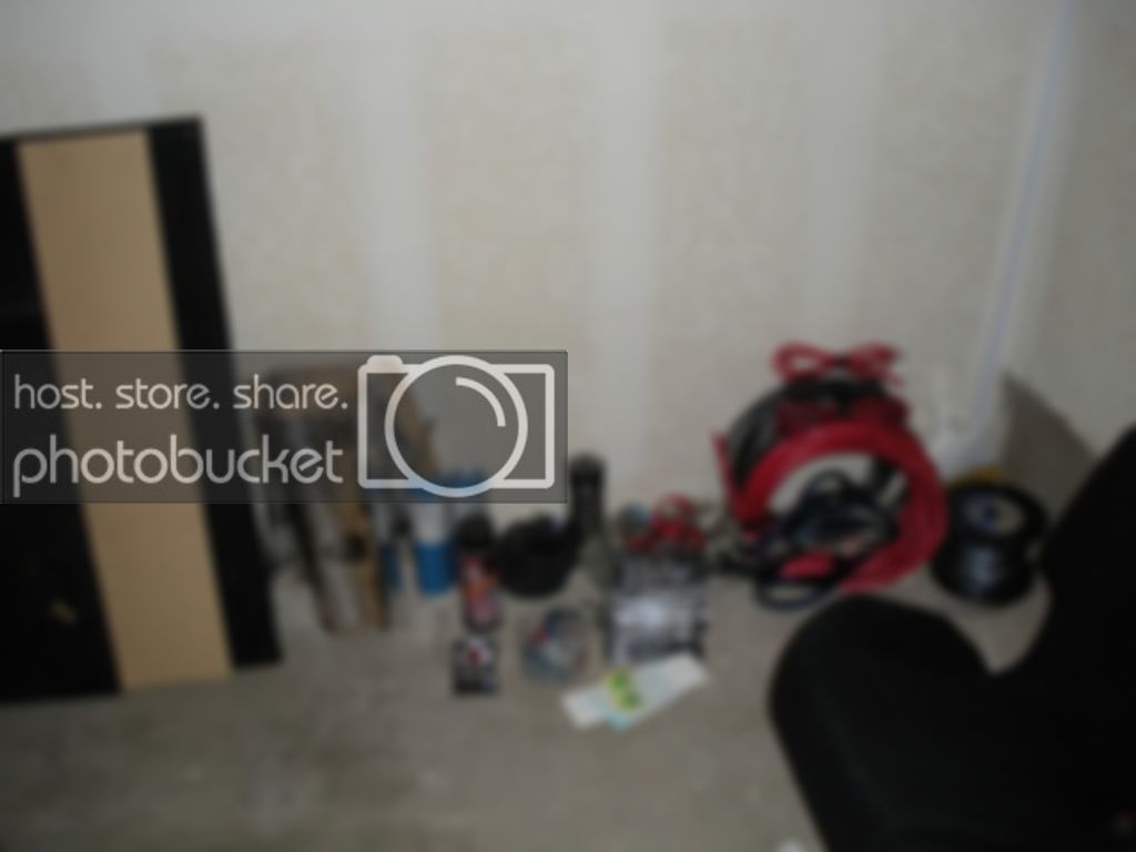

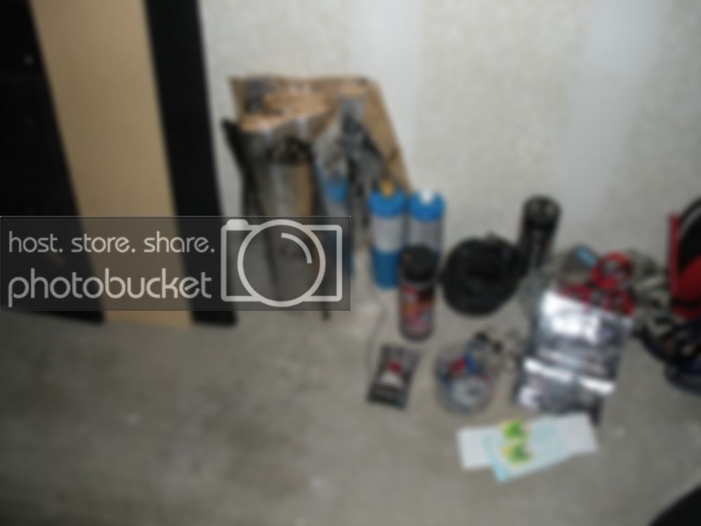

Pictures below are of my left overs- I wasn't very efficient in ordering wires and parts //content.invisioncic.com/y282845/emoticons/frown.gif.a3531fa0534503350665a1e957861287.gif
Nice build, small car for that much beat but hey, like stated before, nothing like a small car for shock and awe.
btw, since they are leftovers and you don't care about them, I can pm u an address that will take care of your trash in an environmentally friendly way, specifically 0ga, fuseholders/fuses, and dynamat
