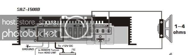

I'm a bit puzzled on how Sundown shows it's diagram. When I wire two DVC 4ohm subs parallel it should end up at 1ohm correct? Which terminals do I use on the amp? Why is there two positives hooked in the diagram? Where the hell is that negative going to also? Can anyone clarify how I should wire them?
you wire all the positives on both subs and going to the amp there should be 1 positive wire.. then you wire all the negatives of each sub . there should only be 1 negative wire going to the sub..
then you put the + wire to a + spot on the amp and a - on a - spot on the amp..
+ to +
- to -
Wires all coils parallel. The amp is a monoblock so both it's + output terminals are connected parallel internally. Same for the - output terminals.
