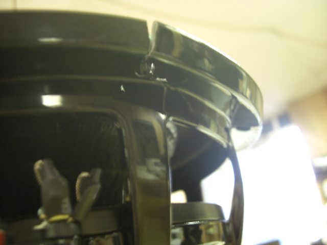

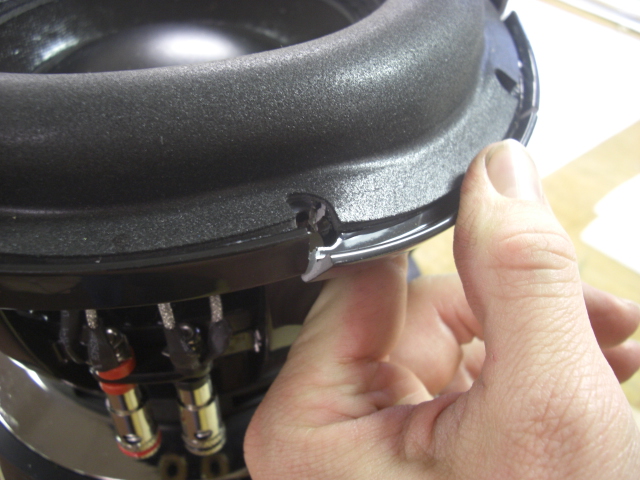

Also... DHL did break one so I took that time to cut it down to show a few design / build details of this driver :
* Nobody likes to see this ! Felt like someone shot my dog when I saw that.

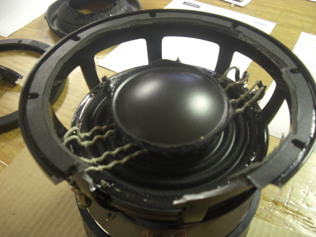

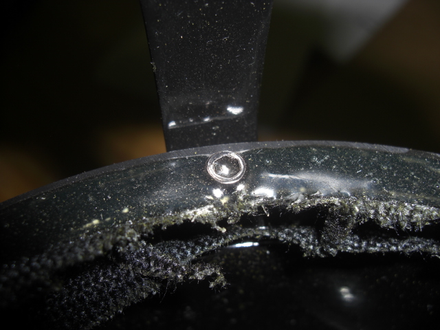

* Cone out... nice view of the double leads.

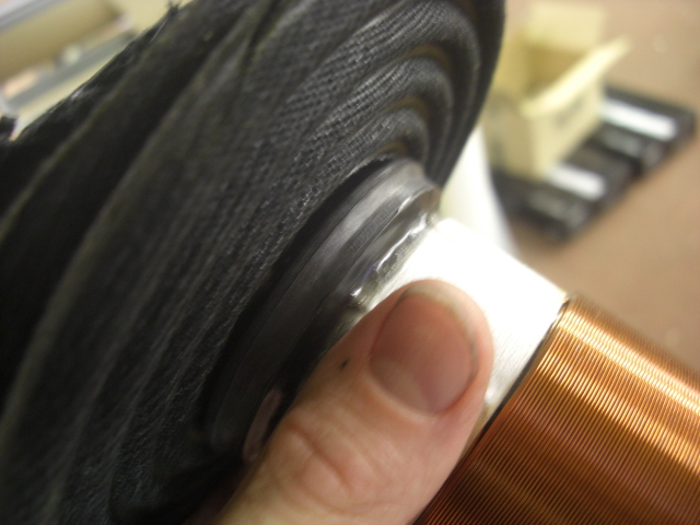

* Bottom triple joint ring that we all know and love from the original SA-8

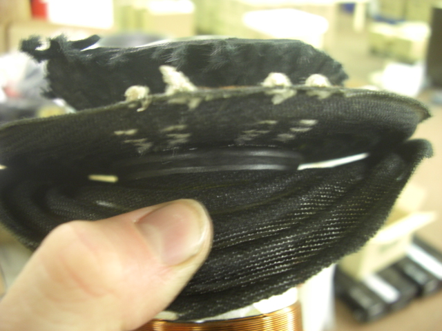

* Second triple joint ring between the spiders too -- I like rugged !

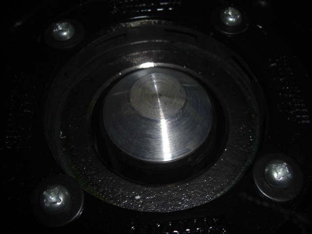

* Pole cap much like the SD-2 models
* Steel ring is bolted in behind each leg of the frame (8 bolts to hold the spacer assembly and spiders in place)

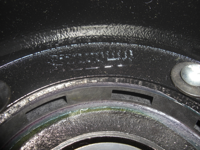

* Internal logos and the inside view of the venting ring. Focuses the air on the coil better as well as building the proper velocity.

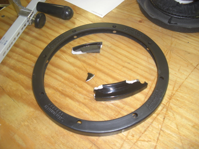

* RIP SA-8 v.2 Frame...
