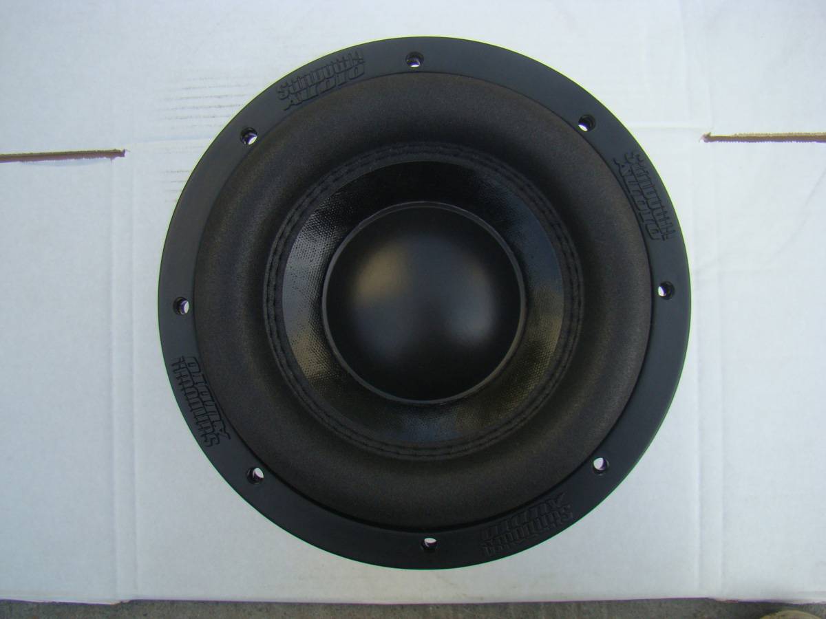

* Custom tooled gasket to fit our new frame with the Sundown logo embedded. Also a stitched on surround like the newest SA / SD-2 models.

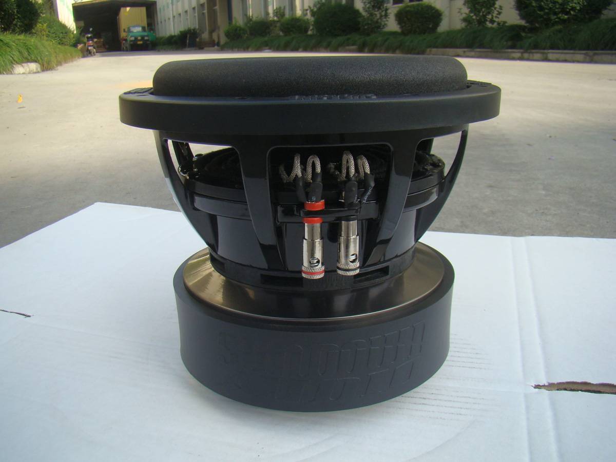

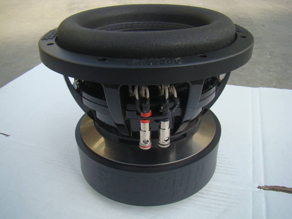

* Side view -- doubled up, tied down, round lead wires to eliminate the potential for tinsel lead failure.

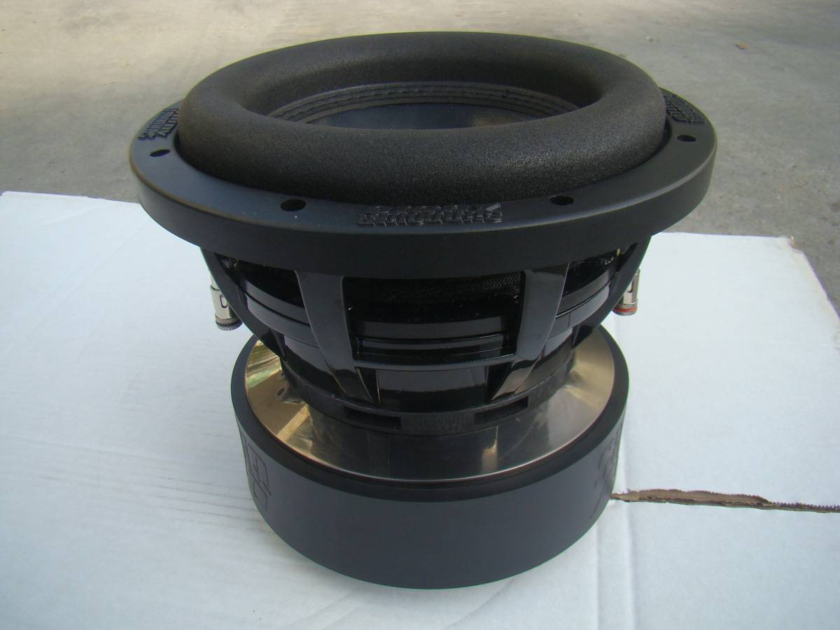

* Also a custom tooled venting ring like the SA-10/12/15 series (complete with logo). You will also note the dual, spaced spider setup. Each spider is 10mm wider than previous SA-8 models for more maximum excursion before mechanical damage.

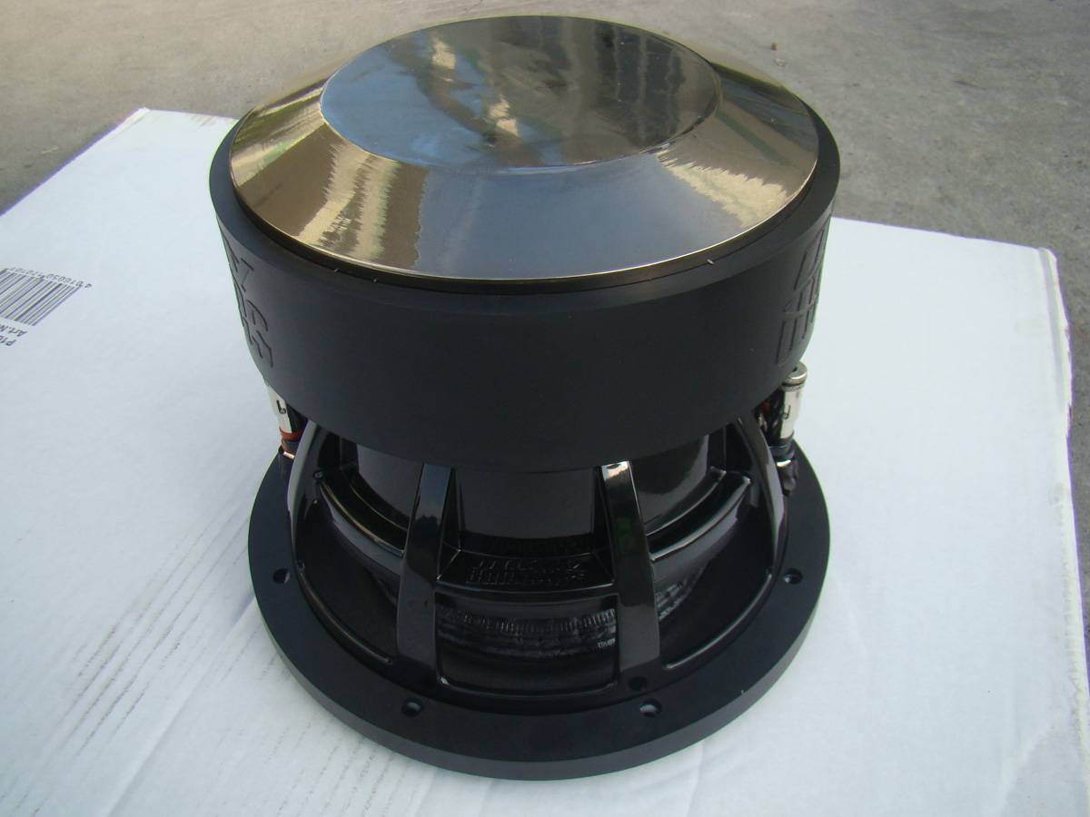

* New motor design with new magnet boot tooled to fit... this new motor is also complete with a shorting ring on the magnet ID like the new SA-10/12/15 models for lower distortion than ever.

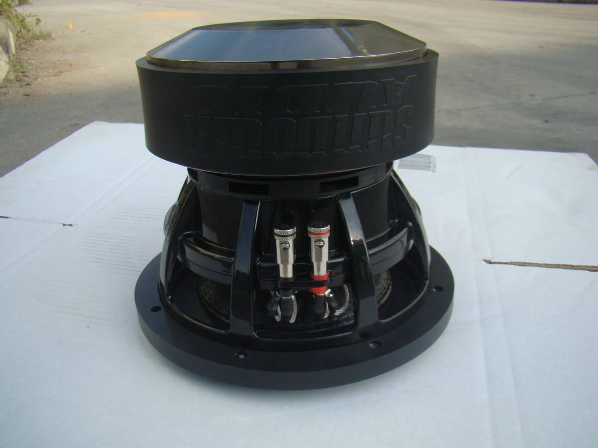

* Rear view. Note the Sundown logo tooled into our new frame.
The new frame tool eliminates the x-mech limits of open tooled frames... it also allows us to use a wider spider and to channel the air like I wanted through the spacer ring.
We were also able to implement dual round leads to eliminate the most common form of abuse damage on the 8s -- which was lead tearing / burning.
