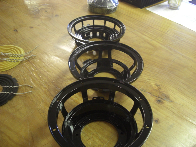

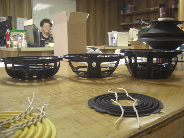

* Progression of the baskets... to the left the original 12-spoke, then the 8-leg, and now the fully tooled Sundown frame!

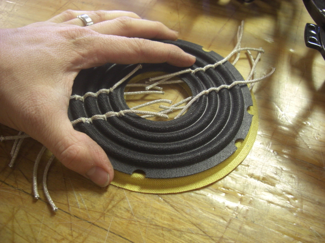

* Wider new spider on the left and older spider on the right (we have round lead spiders in stock for re-cones)
* 10mm wider with an entire extra roll on the outside.

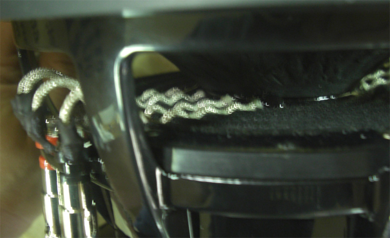

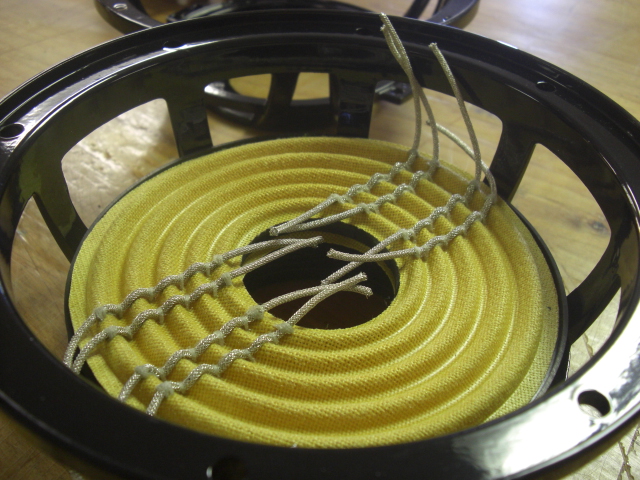

* Doubled up / large round lead wires.

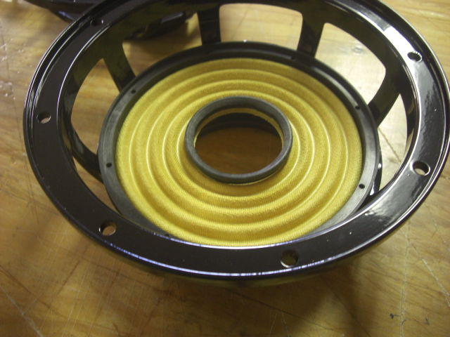

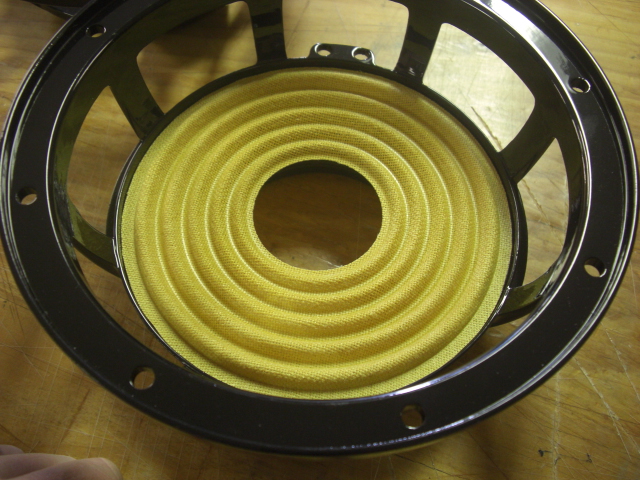

* First step -- bottom spider with no leads.

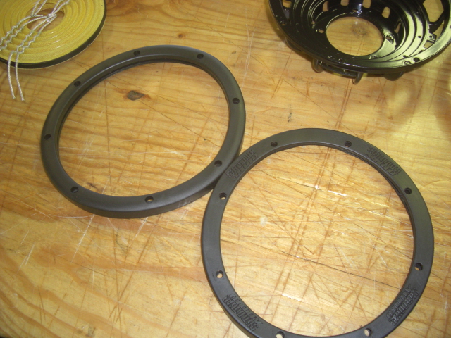

* Second step -- spacer ring in place and center glue joint support ring (there is another behind the rear spider as well)
* Then the top spider on top of the spacer ring -- there will be a steel bolt-on ring on top of all of this in production.

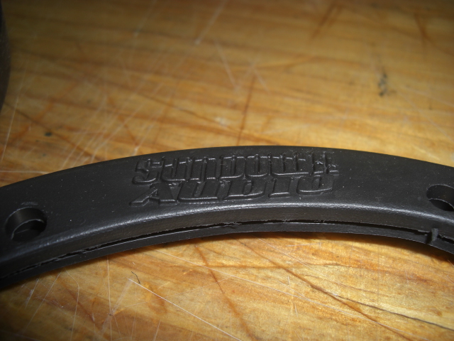

* Logo in the basket base inside, under the spiders

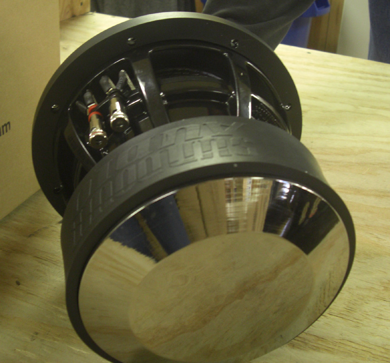

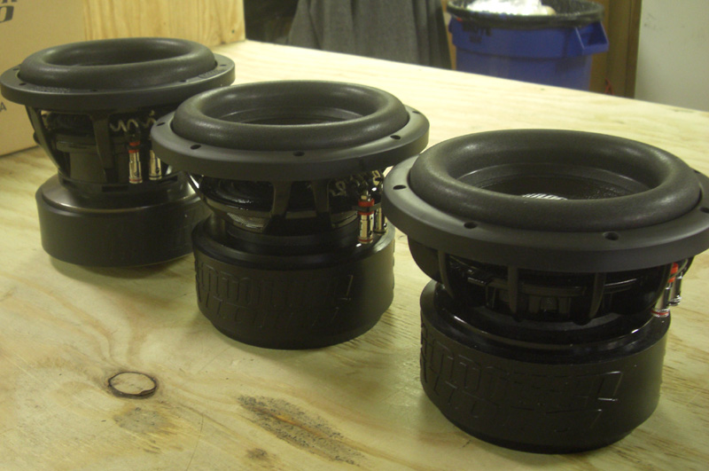

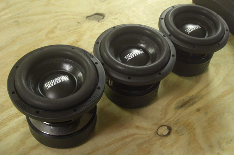

I am super excited... just unboxed the first one and took pictures as fast as I could... will have a free-air video up soon... more testing ASAP :
* Newest @ left to the oldest @ right.
For reference it was CRANKED -- I'm not sure what it would take to get that kind of throw in a box but it would be ALOT of power. At levels that the original SA-8 would be making bad mechanical noise this one is dead silent -- I was excited so I pushed it as far as I could right away in the video *laughs*
Doesn't change the price at all -- the parts had to be custom tooled anyway. The goal is to fend off copy-cat products using my molds that I paid for.
Oh, thats nice. Its not that I dont like the looks, just figured it was an added cost that wasnt needed. But since it didnt effect cost it serves your purpose and looks decent too. The first SA8s were a very nice driver... I've gotten away from using 8s, but these might pull me back in //content.invisioncic.com/y282845/emoticons/biggrin.gif.d71a5d36fcbab170f2364c9f2e3946cb.gif I can only imagine how beastly these look in person. The originals suprised the hell out of me!
