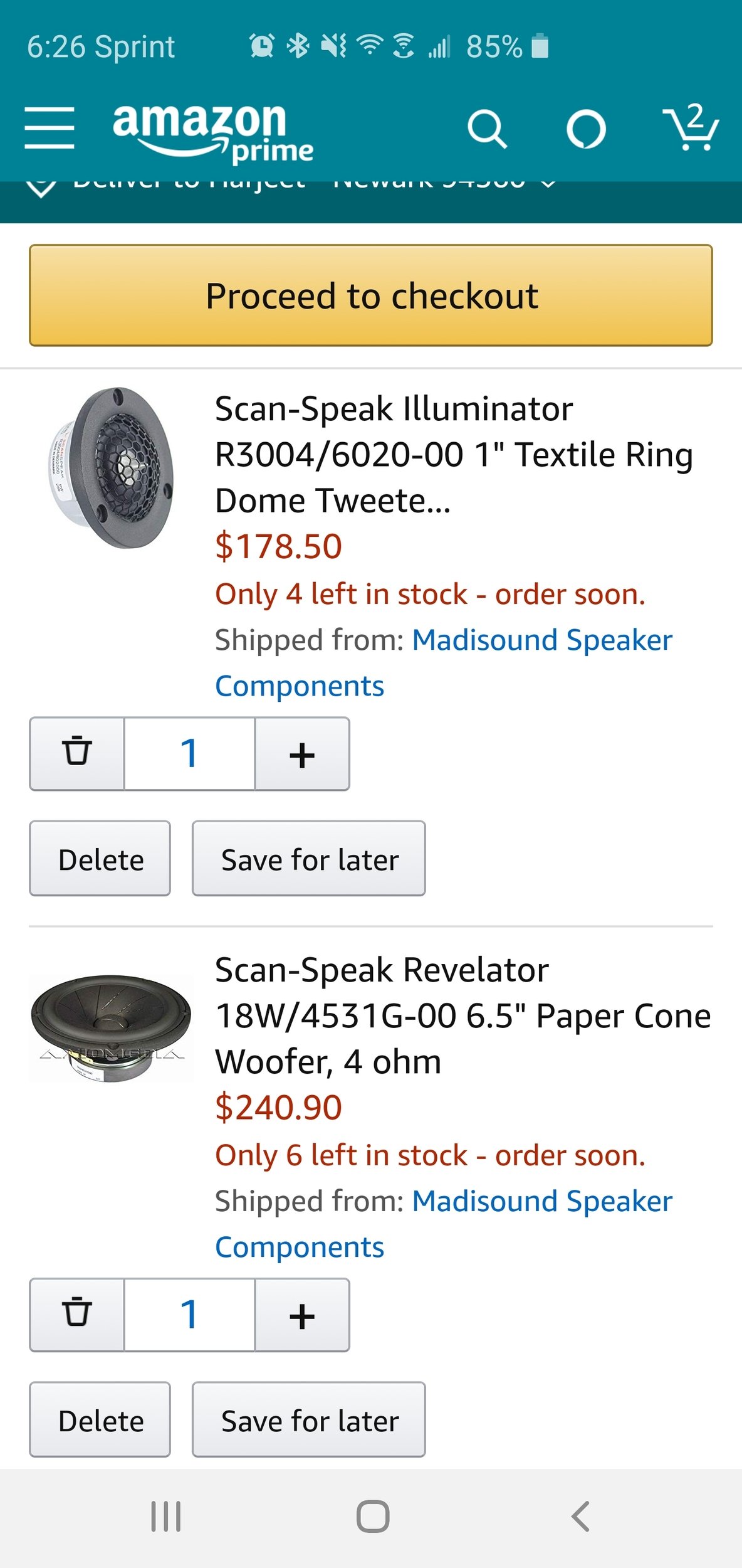

$600 could get you Scanspeak Revelator 18Ws and Scanspeak D3004/6020 tweeters.

Alright I screenshot the speakers on Amazon and tell me if I'm getting the right ones. Now for my 4 channel amp, can I use my alpine pdx f6 or replace it?

U need an active crossover now. Your head unit won’t do the job like you want it to. The components would of been easier because they come with a passive crossover but the active can achieve more and a better sound to what you have. But then on another note, on components, the passives aren’t that bad because they are made special for that specific driver and tweeter. But go active if you know what you’re doing. If you are not familiar with active crossovers then go with hertz components. Focal are better if you have more money to spend. but for the price you are trying to spend, hertz components would be the route to go in my opinion.
