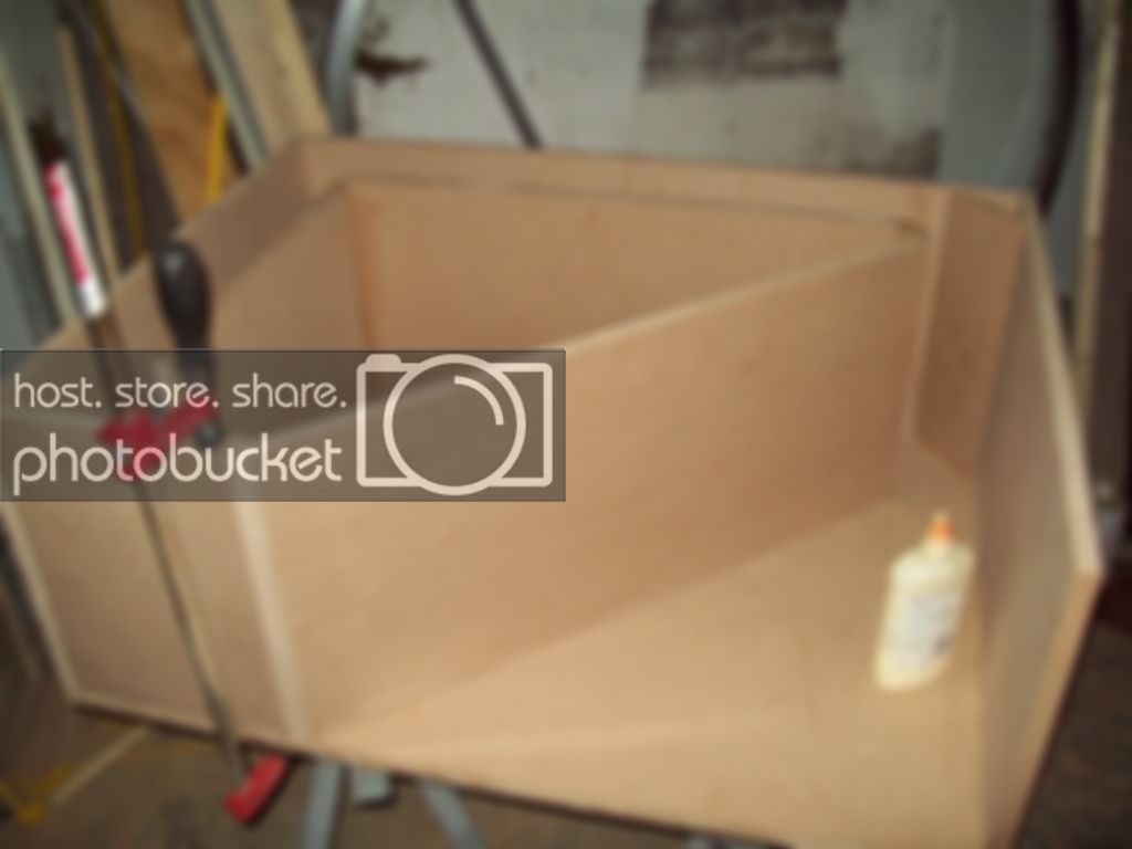

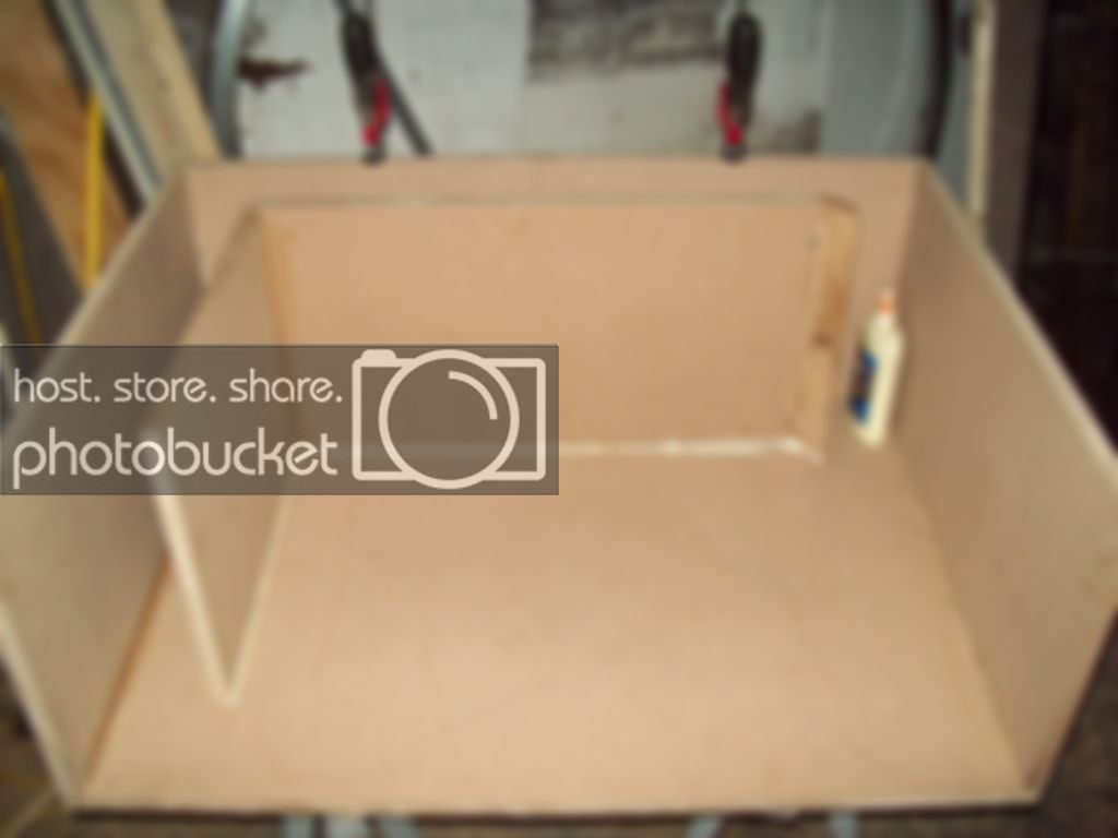

sounds great. lacks the LOW end punch from a sub. so thats were we pick up at. i allready built a box thats 4 cubes tuned to 27hz for a single 15. now i'm going to do another build for a pair of 10's. 3 cubes @27hz. whatever one i like, i keep. the other one gets sold. NOW, before there is ANY flaming, i learned a very valuable lesson in this build. never try to cut a full 4X8 sheet on a tiny table saw. that was the only way i could get it in the back of my car to get it to work for the build. //content.invisioncic.com/y282845/emoticons/crap.gif.7f4dd41e3e9b23fbd170a1ee6f65cecc.gif

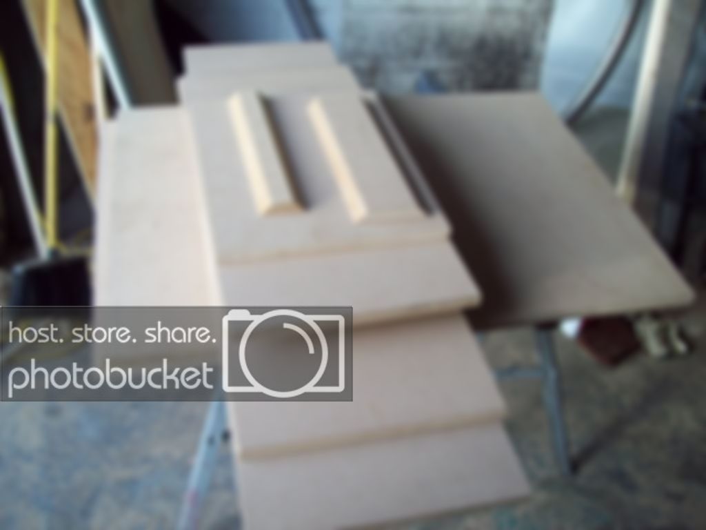

cuts all made and ready to go.

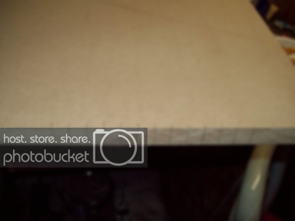

at this point i relized my mistake in choice of table saw. //content.invisioncic.com/y282845/emoticons/frown.gif.a3531fa0534503350665a1e957861287.gif
humm. what could we be getting ready for here???

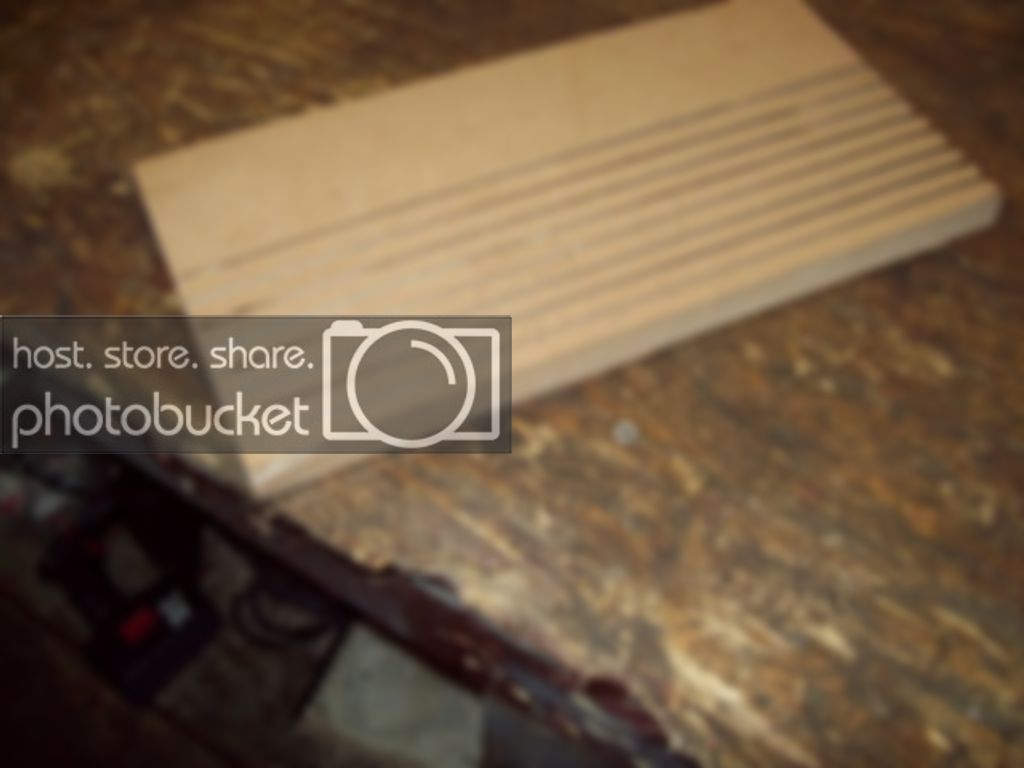

my test cuts on another peice came out perfect. this one, didn't wanna bend AT ALL. same depth, and spacing. i cut just a little deeper, and it ended up breaking. so, i learned kerf cutting > me.
so after a little thinking. this is what i ended up with for now.

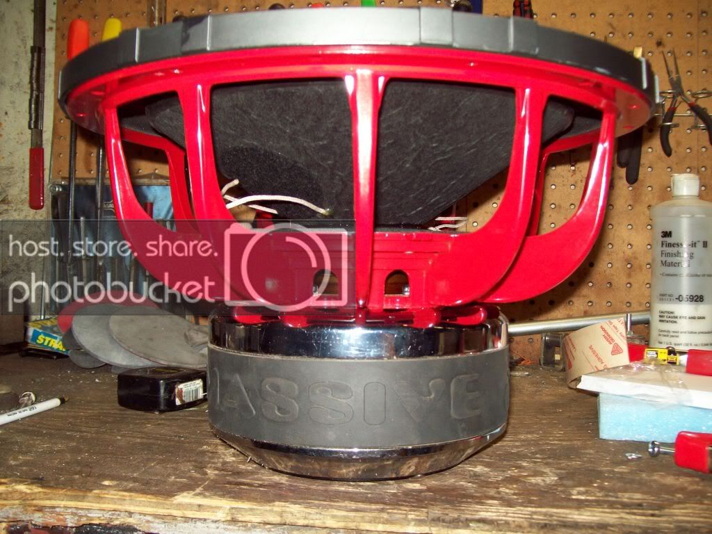

On a good note, Jacob got my woofers shipped out, and will be here tomarrow. More pics then. //content.invisioncic.com/y282845/emoticons/biggrin.gif.d71a5d36fcbab170f2364c9f2e3946cb.gif
update: just got the BM's in from Jacob. Me and the router are going to make some dust here soon. Pics should be up tomarrow morning. //content.invisioncic.com/y282845/emoticons/biggrin.gif.d71a5d36fcbab170f2364c9f2e3946cb.gif
