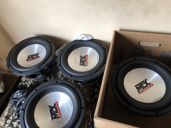

(1) I got two mtx 7510-44
I bought the 1500bdcp to power them
The subs are 400RMS
was going to run them @1ohms, the power I was giving them would be around 1100/1200watts
Now I’m thinking @4ohms will be sufficient power an I’ll get better efficiency
@1ohms the power from the amp is to much for those subs

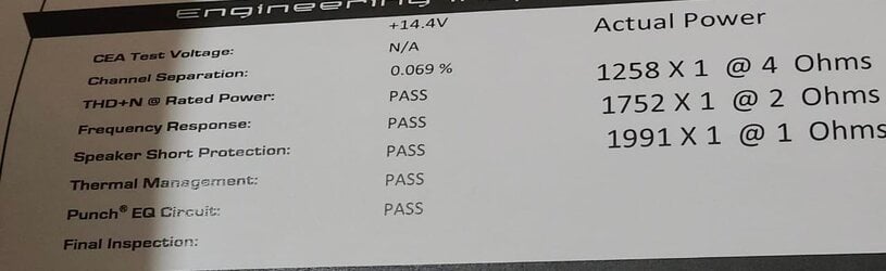

Data from Rockford site
Rated Power
(RMS Continuous Power)
1000 Watts x 1 @ 4-Ohm
1500 Watts x 1 @ 2-Ohm
1500 Watts x 1 @ 1-Ohm
Dynamic Power
(PVC/PowerCube®)
1045 Watts x 1 @ 4-Ohms
1549 Watts x 1 @ 2-Ohms
1715 Watts x 1 @ 1-Ohm
An I will add the birth sheet from my amp if it’s different
