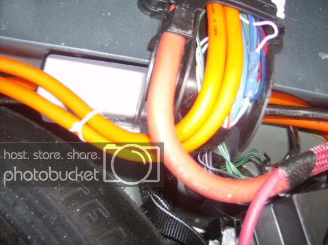

I'm an idiott, I went to hook up my 4 channel today, and noticed that my vehicles entire electrical is ran with, what looks to be, o gauge, says "welding wire" on the jacket. The red wire is coming from my alt, the orange wire is what I was using to run my old KX1500.1.
[/img]
[/img]
So, it looks like, all I need to do is run 0 gauge from the 2 extra batts I plan to put in the trunk to power the amps. Do you think it would be beneficial to run 2 more runs of 0 from the alt to the extra bats or just wire the batts in parallel off the 1 bat being charged by the alt?
